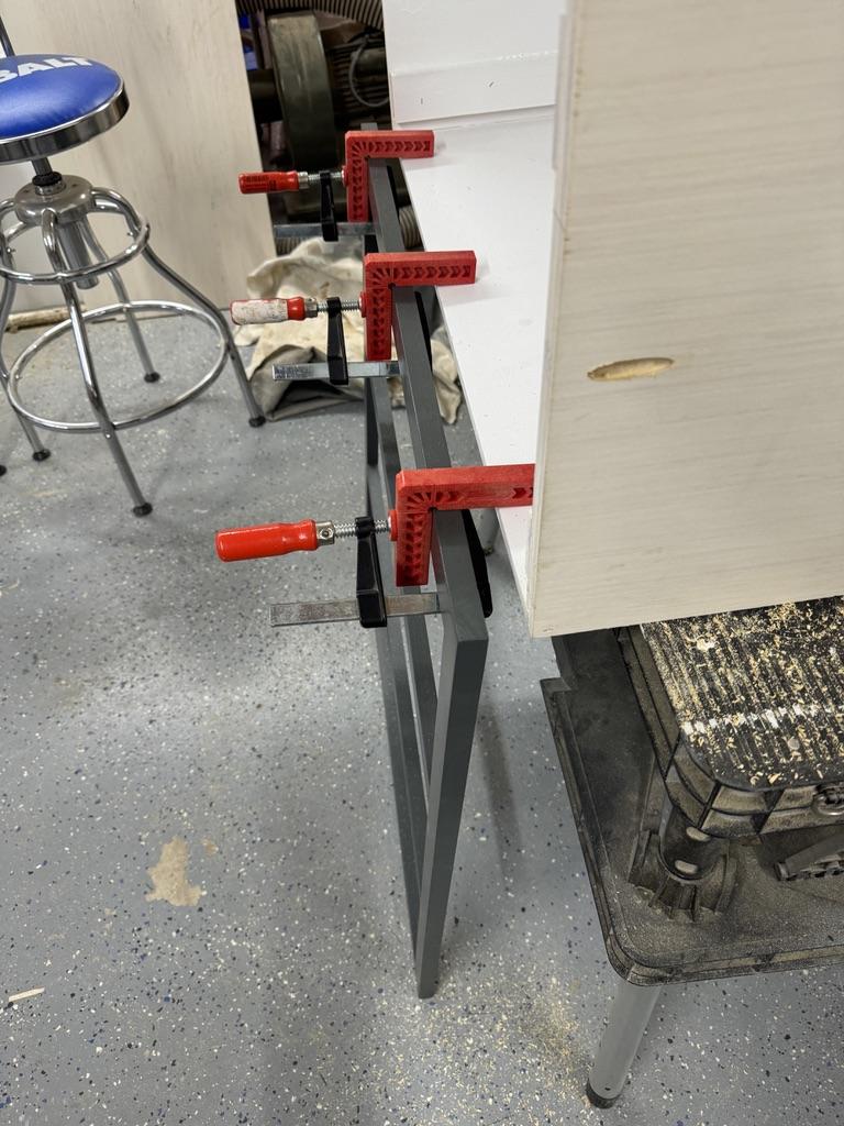

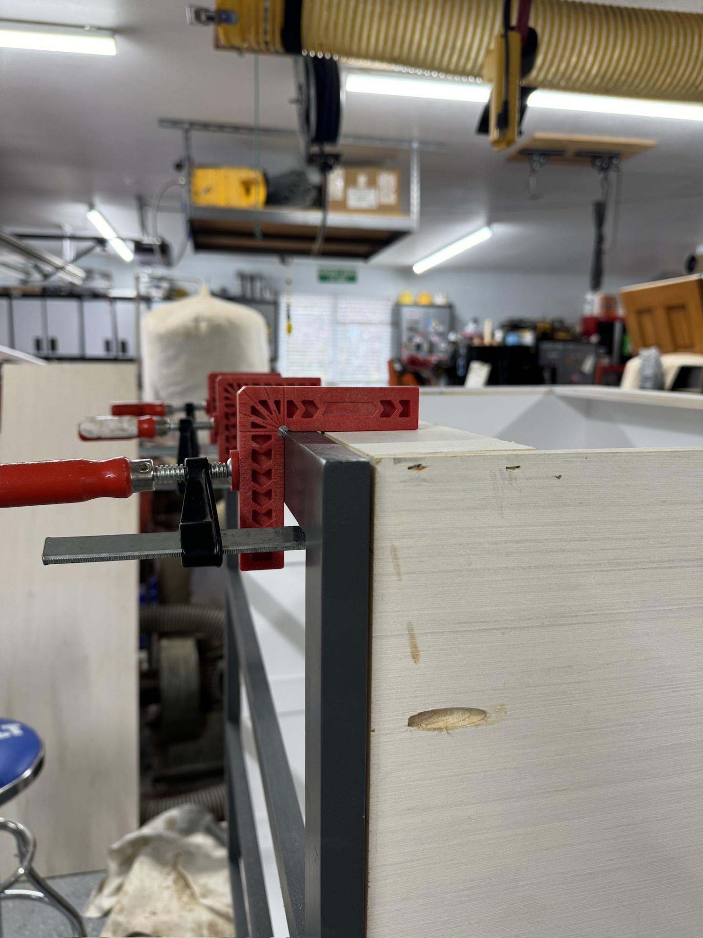

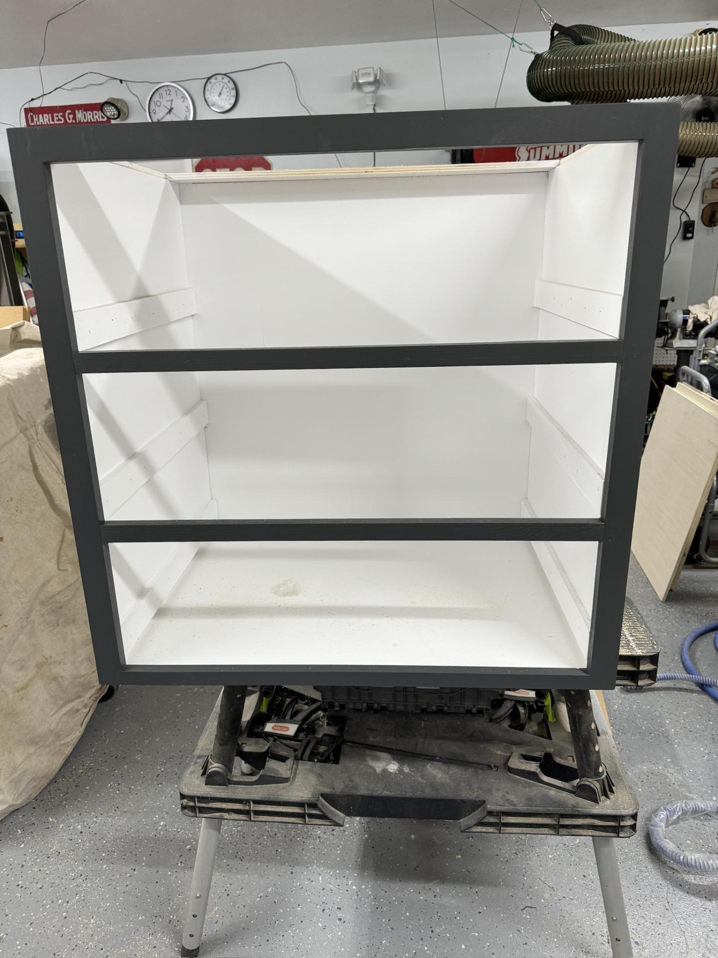

This was my practice piece trying to figure out how things go together.  I have been practicing spraying paint along with the build.  I haven't got the wood for the drawers yet, I will get it in the next few days.
I was having a hard time trying to figure out how to hold the face frame to the base before I glued it, and pocket holed screwed it.  I came up with this idea.

Thanks.  This will be the first time I have built a full on set of cabinets.  My wife is still working on the design of the kitchen.
We are going to flip the kitchen from the front of the house to the rear.  Currently it is a sort of "L" shape.  She wants more of a galley style.  So before we do any work inside I taped off the floor in the design she thought she wanted.  We are changing things a little here and there.
I am doing some practice cabinets that will end up in the garage, I figure If I mess them up no one will notice in the garage.  Also she gets to figure out the style she wants before I have to much invested in time and money.
They are being built without a toe kick, I will make a 3/4 inch plywood four inch wide base then secure and level it.  The boxes will be placed on top and secured to it.
