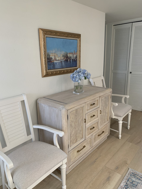

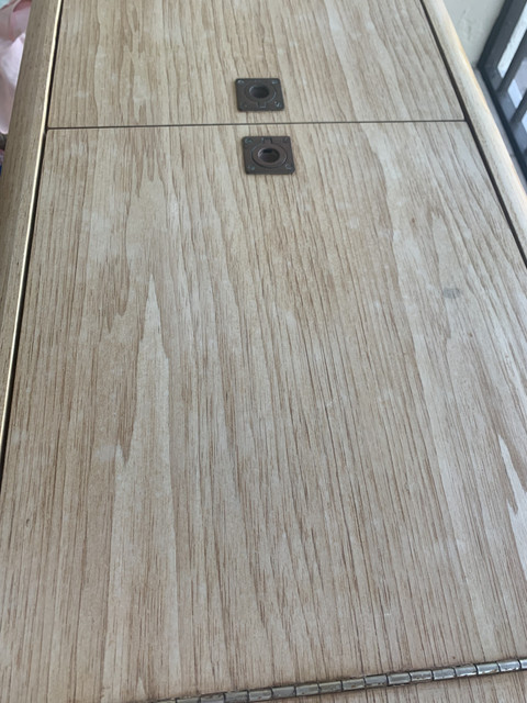

Right now the coffee table I’m doing is an Ethan Allen maple.
The server I did last year was an old Thomasville, no idea of species… but I’m sure it was mixed. The frame seemed like maybe pine? Very soft. Except no grain.
Front a burl veneer. Top and sides I don’t know.
I ended up, after numerous attempts to stain the yellow away, paint washing it.
Pictures attached. Before, closeup of top before bleaching (I think), before paint washing, after.
The coffee table seems better after another application of peroxide; not completely, just better.
 I think the sun is helping. Maybe I should lower the lye concentration next time?
Rinse with vinegar?
More peroxide?

  • Your pickling attempt looks about right to me. Maybe that's the best solution.
