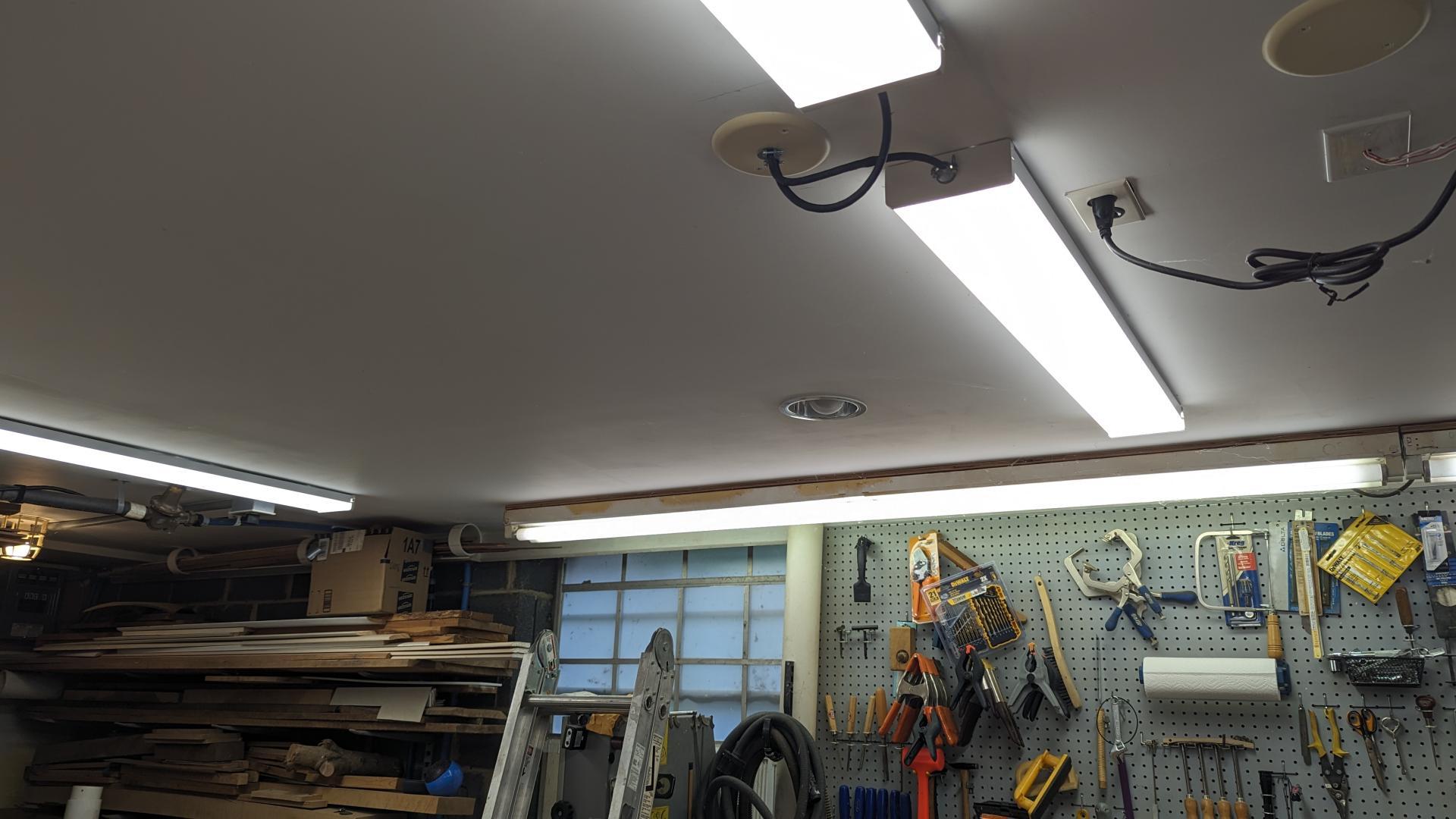

During the process of trying to clean out my poor sad workshop sufficient to actually use it I decided that the lights were part of the overall problem. When I set up my shop a couple of decades ago it was by walling off half of a two-car garage and during the build I installed four eight-foot two-tube fluorescent fixtures and that seemed to be more than enough. But still there was the problem that those big surplus fixtures protruded from the already too-low ceiling and that made wrestling oversized/long stock single handed treacherous so I decided that installing thin flush LED fixtures would be the solution. I found a bunch on Amazon, all four-foot, and decided on not the cheapest but close to it. When they arrived I realized that the cost was enabled by the flimsy construction -- steel the thickness of beer can aluminum is not so strong. But these lights were bright and had three settings for color temperature and for brightness. Setting the switches to "neutral" and "low" looked good. I hate ladder work for various reasons including a once-broken arm, shoulder surgery, age and general uneasiness so wrestling down the old heavy fixtures was a PITA but putting up the new ones was relatively easy once proper mounting could be arranged.
The results are pretty clear. The fluorescent fixtures give something like 65-75 foot-candles at bench height (allowing for tube age and surface dust) while the new LED fixtures manage 150. Almost too bright until you get acclimatized. Ceiling clearance is improved by perhaps 4-5 inches and no fragile glass tubes are exposed. I still need to change the last two out but this will entail moving my massive oak bench and perhaps the bandsaw too so I'll leave that until some motivation accrues.
It is difficult to judge because of auto exposure but here is what the present state looks like.

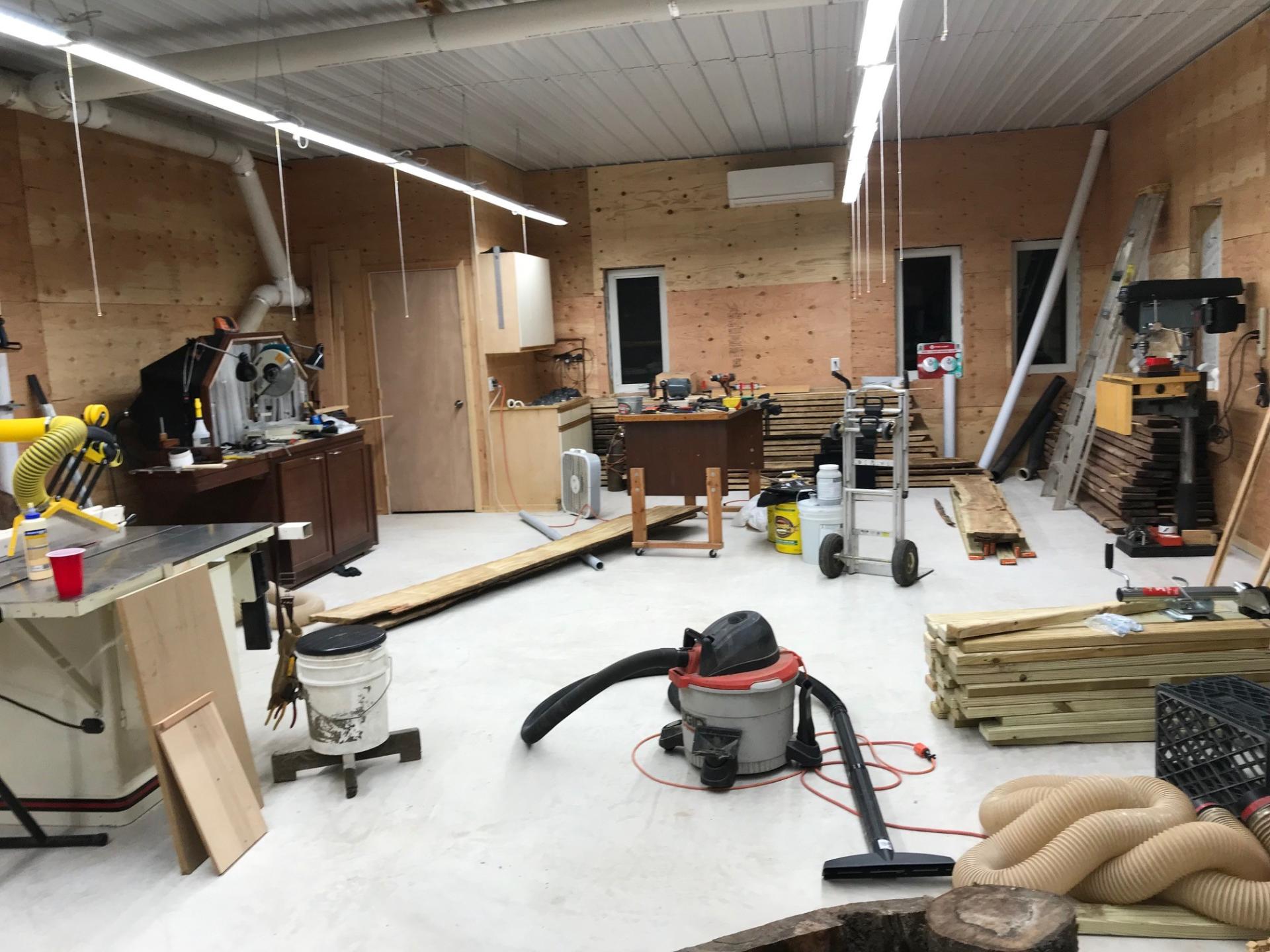

When I built my shop/studio, I opted for 10' ceiling.  I then hung 2 rows of 8 leds located in the middle of each half of the space and 1 foot below the ceiling.
Very even light across the whole space.  While each bank is switched separately , I can also turn off individual fixtures when needed (or not needed)
They've been doing well for 3 years.  Since I bought the whole set from an outfit in California, it's a fair bet they're Asian.

Success! Sorta...  Well I managed to get up the third pair of lights by rolling the miter saw cart and router table cart out of the way and stretching a bit to get over the drill press. The fourth pair was always going to be the beast. I was able to slide the 16" bandsaw away from the wall with some effort and rocking but the bench was the (near) killer. I did eventually get it away from the wall inch by inch far enough to get a short step stool behind and finish the install although the space around the bandsaw and the end of the lumber rack was still difficult. Now there is one problem -- I cannot even begin to get the bench back in place -- dragging is easier than pushing. I hope that there is a solution though -- I ordered a set of "bench casters" which are foot-activated and raise "600 pounds" and I'm hoping that when they arrive (tomorrow?) I'll be able to mount them and roll the bench back into place. Anyway, the lights are done and the shop is bright as never before but I still face the task of cleaning up the horrible mess that I allowed to accumulate over the years. Oh, and I now have four unwieldy light fixtures and eight toxic tubes to dispose of...
