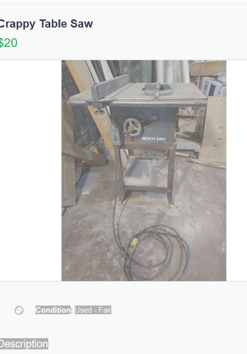

So I had a look online. Actually a lot of these are going for 250, maybe post COVID rush on indoor activities. Did find this under "crappy saw". So long as the blade is the bent part, and the arbour has low runout, should be ok, with a few hours work. But it proves concept. That is about 15 dollars US. So live a little, spend 3X that much.
