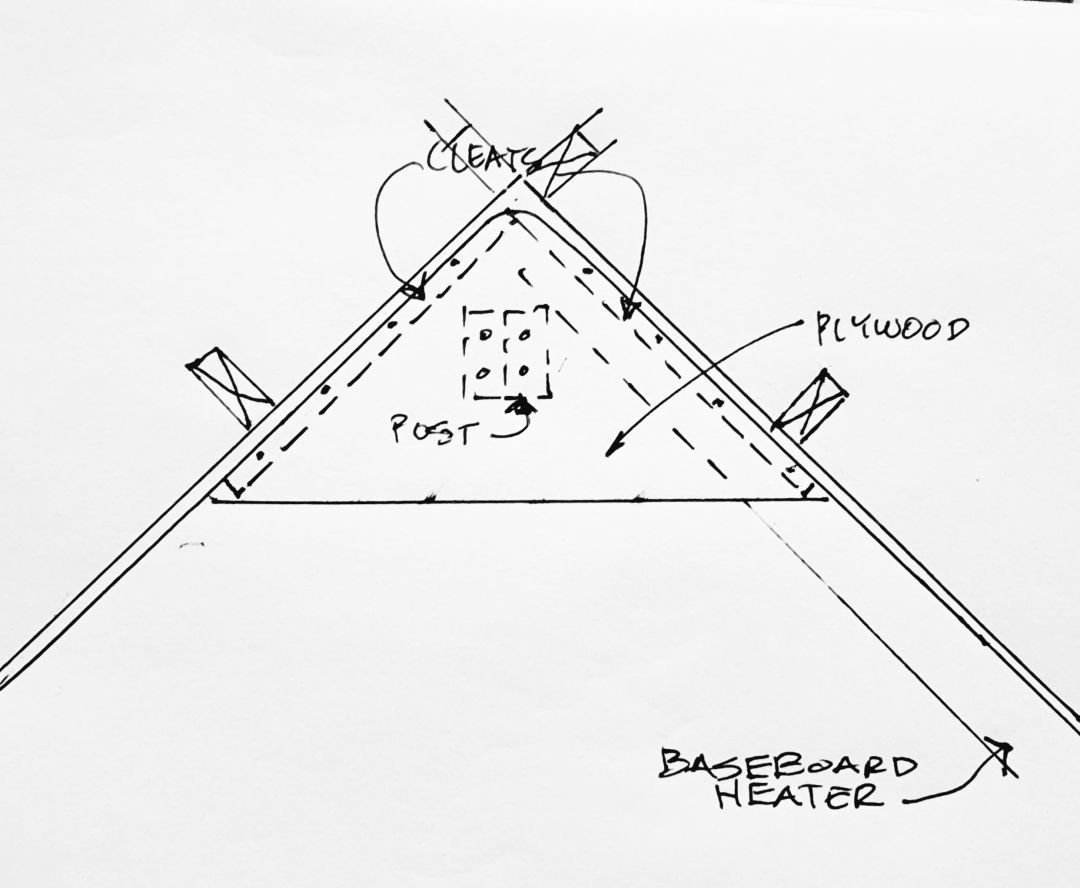

The solution to your problem is in how to  keep the top of that corner post from moving side to side. You don't need to worry so much about the bottom, because there is a top beam (double 2x4) that will keep the posts from leaning in toward each other or collapsing. You could probably get by with just a plywood foot, shaped like a home plate, under the corner post, screwed up into the bottom of the post. The top is where you need to get creative. If it were me, I'd make horizontal 2x3 or 1x4 cleats to screw to the wall on the two walls, then cut another piece of plywood to screw onto the top of the post. It's best if you can screw the cleats firmly to the wall studs. Your downside as far as damaging the apartment will be a few screw holes into the drywall where you attach the cleats.
Here's a down and dirty sketch for you. It's pretty rushed. Let me know if you need clarification.
