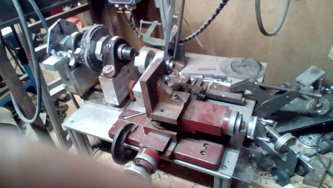

I am doing the threads on a ornamental turning lathe. The lathe spindle is pushed out and turns with a lead screw. The cutting tool is stationary and rotates at about 20000 RPM. It's 11 threads per inch.

Thanks Ray.  A bit above my meager abilities and/or equipment.  Do you have any pictures of your ornamental lathe set-up to share?

Thanks Ray.  Very cool looking apparatus and from the initial picture it works very well.  What other forms can you make with it?  I assume it is not limited to threads.  Your own design and construction?

You can do almost any pattern.
