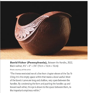

I'm a very mediocre carver and really wish I could create the sort of carving featured on David Fisher's drop-lipped bowl in August(?)/April(?), maybe neither, but definitely 2022 issue of the AAW journal. (White tube turnings on cover.)
I've been thinking of how to get that dropped lip on the bowl and realized he probably turned a cylinder first, shifted the axis slightly and turned again. Still in a cylinder manner, but eccentric, cutting into one side but not the other. Maybe going 1/3 down.
Then, reorient and turn a chuck spigot at the center of the side not impacted by the 2nd cylinder cut. Much like a natural edge potato chip shaped bowl.
Turning a bowl from this will result in a dropped lip bowl.
OK, cool, awesome bowl with a very different look. And if you are Mr. Fisher, you can do some great carving along that lip.

Here's a clip taken from the online edition of that issue of the journal to give you a better idea and maybe see how I figure it may be done. Looking at his website, he may have entirely carved it. I do think a very close approximation (minus the carving) could be done by shifting axes.
Here's David Fisher's website, which has many more interesting bowl forms and great carving.

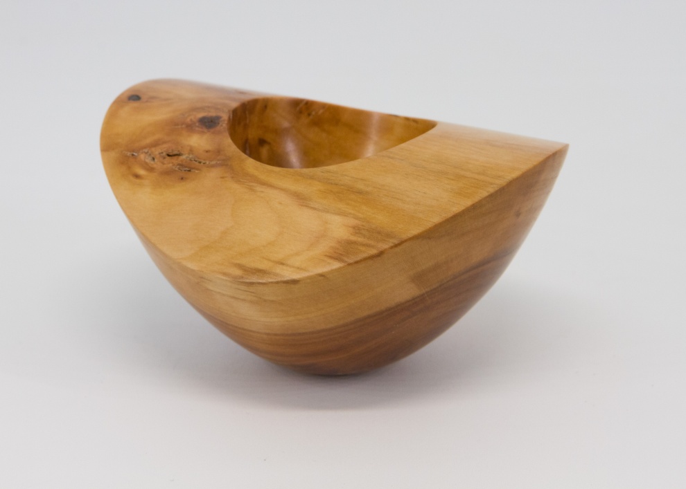

Definitely a two axis turning. To get that droop on the handles, I might leave the rim on the cylinder a bit thicker, but then you would have to do a little more hand removal of wood on the underside at the juncture where it meets the body(?).
For a box, I would probably leave a bit more of the side intact. I made the opening too wide on this attempt. Making a shallower but wider first cut to elevate the handles then leaving a slight lip for the lid to perch on then hollowing out the chamber.
Another gratuitous lathe shot...  of a truly ugly piece of locust.
With a little refinement of the shape this would be a good canvas for embellishment.

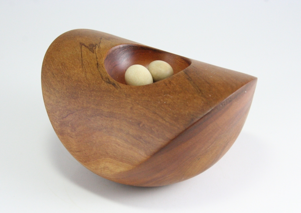

It occurred to me...
that giving the rim on the inside of the cylinder a half dovetail profile as if for recessed mounting to a chuck, might give a better shot at getting a more pleasing curve on the end of those handles. Additionally, adding two more axes by offsetting the center  a small bit toward each handle end might help getting a good shape without as much hand removal of material. Planning a "hidden" carved detail at the terminus where the underside of the handle meets the body might also mitigate hand removal of stock.

Craig, funny you should mention...
I think I've done both variations of what you're describing.  I've done a taller HF with the shallow top, and I've done a HF with the top taken totally all the way around to the bottom.  IMO, both are valid and attractive forms, almost bounding in a mathematical sense, and they were fun to do.  I won a Judges Award from Jane & Arthur Mason for the "tall" one.  They're both in osage orange, purposely to get the grain lines involved in the form.
