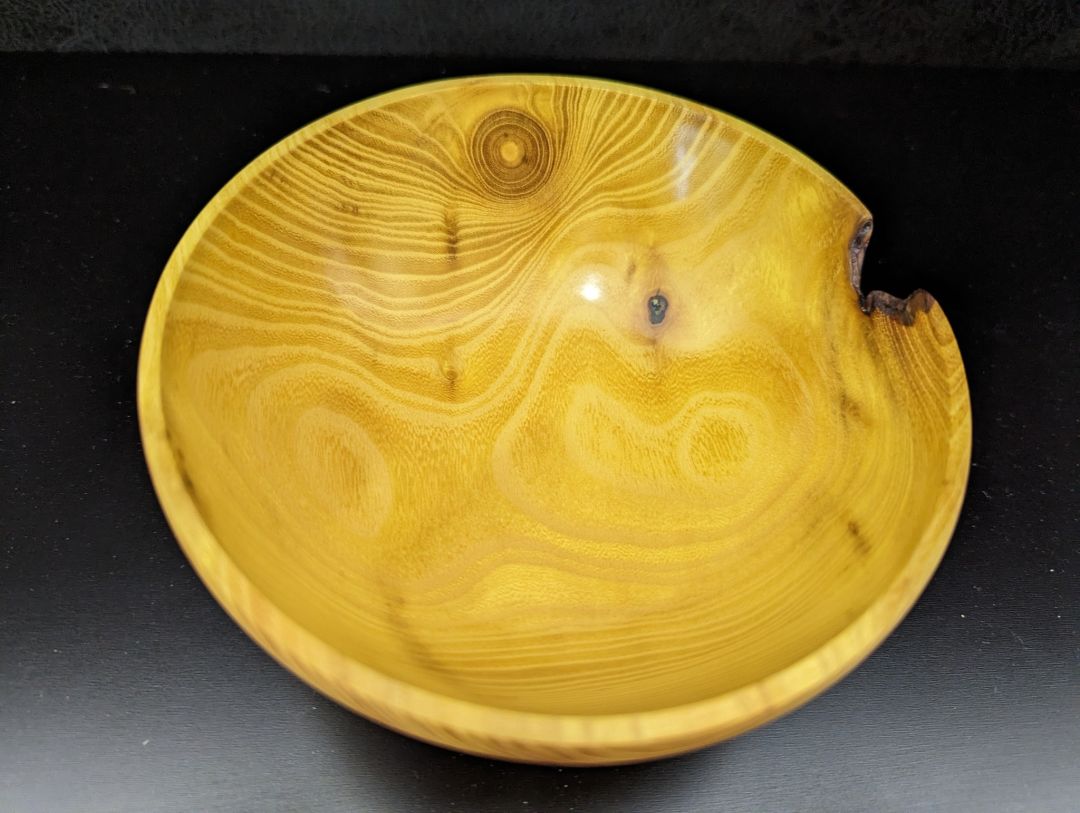

Why not leave the feature in the bowl??
Re: Limb in the Rim
Re: Limb in the Rim
Lyle:  That is what mine looks like and, I am going with "A Feature".
Thanks for all the advice.  Regards, Doug
