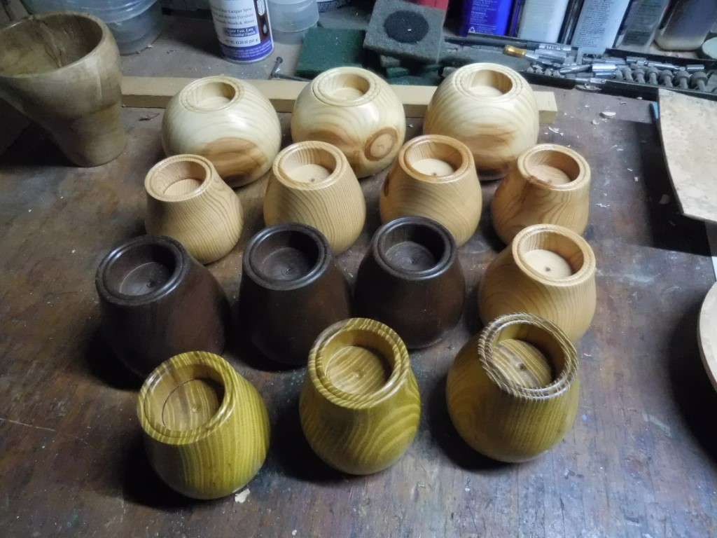

I made 24 of these candle holders to use up an old supply of candles for a craft show last Dec. and sold 1! First show of the year this past weekend and sold all the remaining 23 on Sat. and could have moved more! Years ago I gave up trying to outguess potential sales of small turnings, and now I have to buy more candles to fill an order of 24 more for the Ky Artisan Center. Time to scrounge more suitable scrap wood for this project!

Hey, if you happen to stumble upon a candle maker that makes true 1/4" diameter candles, let me know. I've played with making Sfirri style multi-axis candlesticks in miniature and using brass shelf support sleeves for 1/4" pins as the bobeche. Figured they'd make great birthday candle holders for turners.
I don't drill first, like Mark. Instead, I turn the lower portion and leave a little extra. Then I remount on the other centers and turn a tenon in that extra bit and remount in a chuck with a small set of jaws. Then it is easy to drill straight and accurate using a Jacobs chuck in the tailstock. I usually turn the top after drilling and after having glued in the bobeche/shelf pin sleeve. Then I can just bring up a live cone center to apply pressure when turning the top section.
This order of operation works for the full-sized ones too, though may be better to turn the top before drilling for the larger ones.
