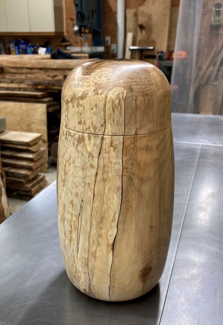

I had planned a double-tapered shape
with the top to be parted off.
Then to refine the shape of the body followed by hollowing both.  Unfortunately I took a bit too much out of the cap in order the glue in the sleeve ring.  When I put them together to cut the final shape of both as a unity, I didn't have enough meat in the cap to continue the body's final curve without losing it.
Hence, this
No, it's Not a Matryoshka doll.

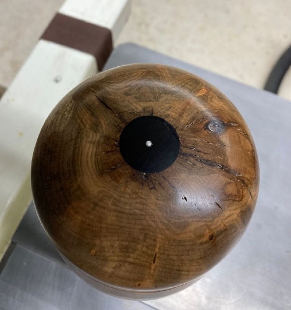

The pith in the center of the cap was in bad shape and didn't lend itself the a resin filling.  So I inlayed a 1" button of ebony and put my signature silver button in that center.
With the radiating annular lines, color variations, and small fissures the inlay reminded me of images of cosmic black holes.
Hence the title  "Black Hole Sun" [not Soundgarden ;) ]
Red Maple 11" by 4 1/2

I want to set the cue ball on that spot (last photo), & try a break.
Re: New Shape [fm] by Accident
coronagraph!
Ha! Indeed . . .

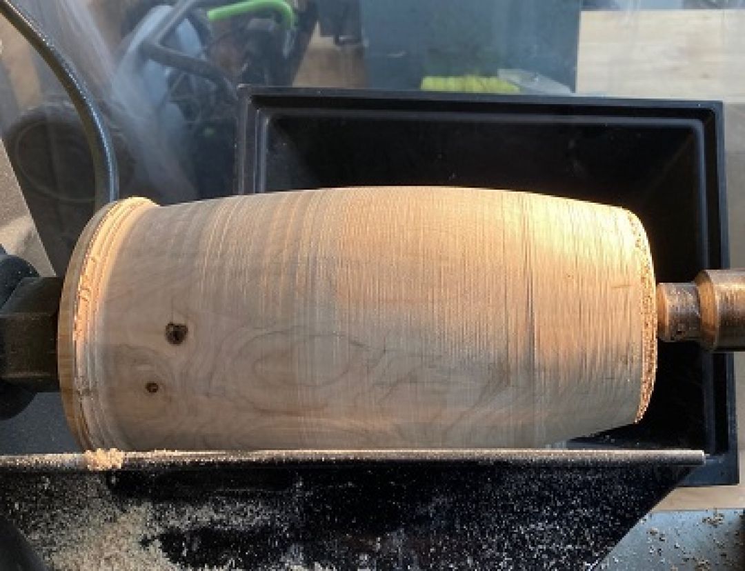

Sleeve?
Very nice especially after a problem.
Do you glue in the sleeve as a wood disk and then turn the interior away?
Thanks,
Bill
Re: Sleeve?
Yup.  I glue up blocks, then turn them round with the end grain between centers with a beveled end to grip in the scroll chuck.  I have them in walnut, cherry, maple, and birch.  When I need a sleeve (tenon/etc), I turn a 1" wide end section that's close to the diameter I'll need, then part it off.  Cookie is turned to a precise fit into the cap's inside diameter then glued in.  The pot's body is then used as a gauge for the final diameter of the exposed half of the cookie taking a 1,000th at a time to get a tight fit.  With the cap/cookie mounted, the cookie gets drilled and hollowed to about 1/4" wall thickness.  The two pieces are then jammed and re-turned so they match with the grain aligned.

PS
I make the cookies so that the resulting ring will expand and contract at about the same rate and direction as the endgrain-turned base wood
If I were turning face grain, I'd make the blocks rotated 90* to, again, match the movement of the piece over time.
