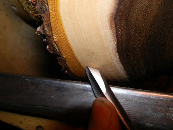

I've been watching videos and reading books.I've ground one chisel four times now trying to get the edge I need. I built a couple jigs.One jig is a sliding one-way style that sets the depth out from the grinder to rest the end of a chisel handle into.The other is in the picture.It allows me to get a grind on my detail chisel that is show in the other picture. I use it with the first jig. Is this a fingernail grind?I honed the inside of the chisel with a slip stone and honed the outside with a diamond paddle.
I need criticism or advice or something. Is this a practical grind for turning small coves in spindles? Is there anything else I should be doing? I tried doing it freehand after watching a pretty good video on it but all I did was make a mess of the edge. If this keeps up I'll need to get a new chisel because I'm running out of edge. Oh yeah,the edge is ground at 32 degrees.---Jack

Go to about 4:45 to see how I sharpen my detail gouge using a Wolverine jig. Your homemade jig should work just fine for this.
https://www.youtube.com/watch?v=BOEL7Q3CpZc

The grind you have should work well, Jack. I also made a jig like yours, but ended up cutting away the front corners so I could swing it a little further to each side, since it was hitting the tool platform (which I have since flipped down out of the way). I think if you went a bit further to the left & right, your bevel would wrap around the sides a little more, too. I don't have a Wolverine, but a wooden V-block on a wooden arm that slides between a few blocks of wood.
My detail gouge looks a little more like John's in the video -- probably a little too acute for your use at ~30 degrees. Sometimes I grind away the heel either freehand, or by sliding the V-block in a ways.

That was a help. I still can't get volume on your videos. I figured out though that it is in my computer. I hear them fine on my cellphone and even on my TV. I get youtube on it. thanks---Jack

"Small cove" - comment I saw recently said the radius of the cove should be no smaller than the radius of the gouge. Don't know if this might be an issue for your spindle results.

The gouge works now.Learning to use it and learning to sharpen it at the same time is tricky. I needed to know if I was on the right track.thanks---Jack

I have three of these gouges. 1/4" 3/8" and 1/2",so no, the gouge size isn't an issue. The cove is about 1/2"wide.---Jack

try roughing at 200 rpm, once you have the blank round, raise your speed to maybe 500 rpm. tops.
I am a skew guy, and love the finish I get straight from the skew. The detail gouge works very similar in spite of looking very different, mine looks long and pointed and works great on beads, for coves try a bowl gouge or a scraper.
