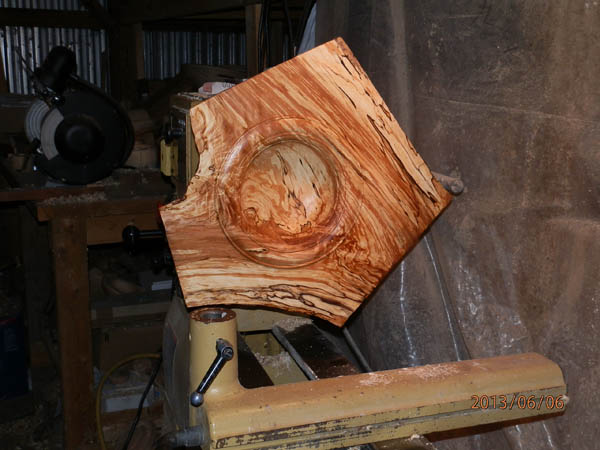

I got whacked in the left elbow while turning a relatively square edged bowl. Lathe was turning at about 750 RPM, and there was a sound at the barn door, so I turned (pivoted) to my right to look around the plastic screen, and allowed my elbow to wander into the spinning wood. I got really lucky. The longest corner -- about 1/2" thick at the time -- hit my forearm about an inch from the bony knob that sticks out, where the Ulna is still pretty thick. If it had hit a little further from the elbow, it might have broken the bone. I couldn't do much with that arm for a week or so, but all I really got was a heck of a bone bruise. Turns out, no one was at the door -- just the wind rattling the loose window panes!
I went back out to the barn and set the blank on the floor about a week later, and there it sat for about 2 years. Last Spring I decided to finish turn the thing, which is seen here on the lathe during finishing.
I can send a larger photo if you would like.
Safe spinning,

Holy Smokes -- that's the real deal. Still not much use/strength after years of healing?
Glad you were able to salvage the hand -- that's scary.

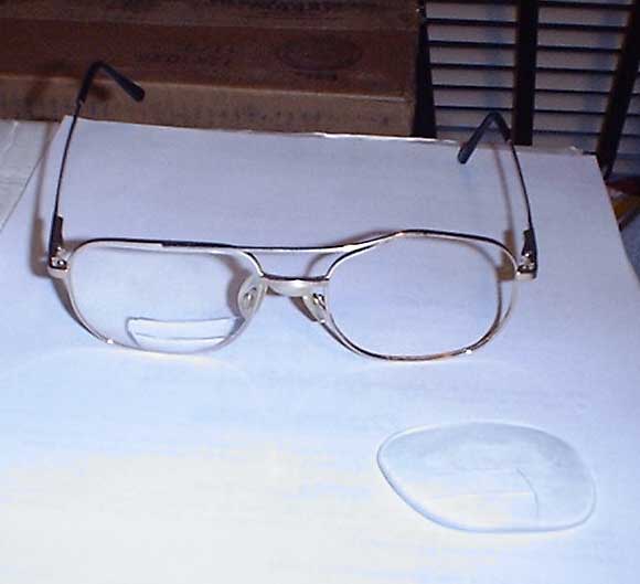

My accident was not a turning accident, but one of preparation. I was going to saw off a thin piece of oak (about 5/19") on my table saw. I didn't think to change the blade throat plate to a no tolerance blade plate. The result was an 8" long piece of oak hit me at the top of my glasses, it knocked me out for a few seconds. When I gathered up my wits and turned off the saw, I staggered into the house and let my wife fix me up.
It must have been about 30 minutes later that I realized my glasses were missing. I still have a scar on my eyebrow and the is what my saving grace glasses looked like.

Close call, Jim (as in, it could have damaged the eye itself), so I'm sure you are relieved at that.
I'm not entirely convinced your eyesight came through unaffected, though..... 5/19" ??? :O
...I'm thinking 5/16", right? 8)
Safe spinning,
Brad Vietje
Newbury, VT
Re: Got a good accident story? *LINK*
Jim Evans
Jim Evans
Well Brad you could be right. At my age I've just started getting floaters and seem to be able to make more mistakes and miss a whole lot.
But I thought 5/19th was a metric measure. ;-)

Jim, very glad you walked away from this one relatively uninjured. The hip pocket will take a hit though replacing the bifocals. We all do strange things at times but you are a very fortunate turner as a little either way & it could have been quite a different outcome. As turners generally fit the over 55's demographic the most significantly reported injuries are slips & falls which lead to traumatic brain injuries etc.
You being unaware of what happened after the impact for a few seconds around a running table saw and one probably with no guard (?) is very concerning. Such an impact has potential for a secondary injury that may be far more significant than the original impact. Either collapsing / falling into a running saw or striking your head against the saw itself, other machinery or the shop floor is a very concerning scenario.
Mate, please do yourself a big favor and review how you are using the table saw to make thin rips and please invest in a decent quality polycarbonate impact rated Z87.1 face shield & perhaps hearing protection as well?. Often the best thing we can do for ourselves is to take a little more time to think things through and to review all of our "work" processes to see just how safe we are before we do them.
