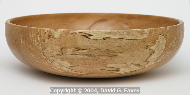

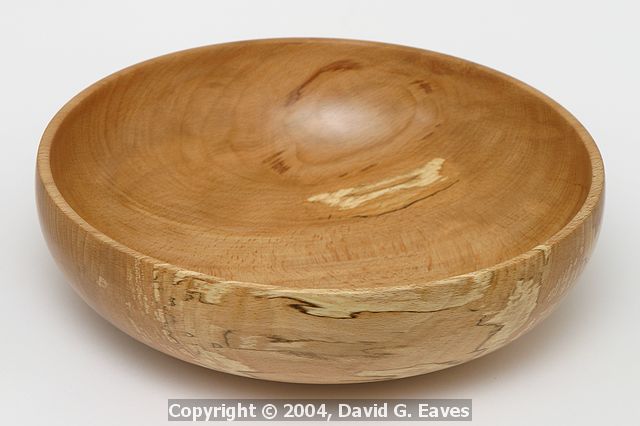

I turned the latest iteration of my round bottom bowl today. I posted the other one last weekend (see thread here). My conclusions with that, and the observations of others was it was slightly too heavy as the base was just a smidge too thick.
I started off with a 9 x 3" blank the same size as the previous attempt. Todays wood was Beech, the bonus being it was slightly spalted :o)
The form was turned similar to previous, this time I undercut the rim more inside so to create a shadow to highlight it.
The bowl was sanded up to 400 grit, sanding sealer applied. Then tung oil and sanded up to 600, burnished with brown paper and then waxed and buffed up with paper cloth and a lambswool polishing mop.
Was turned using a spigot (tenon) and this was turned off using a padded disc and a live centre aganist the base (final bit power sanded off) I was trying this as a different way and it worked well.
Any thoughts on how this has worked and how to improve are much appreciated.
Overall view
Side view
Straight on profile
Thanks
Cheers
David

Richard Allen
Something to consider
Richard Allen
>Hi David
Terrific bowl. Good shape, good finish. The previous one of this type appeared to have a little tear out. I couldn't detect it in the pictures of this bowl.
The rim is an opportunity which you appear to have avoided. A sloping in rim will have an impact as will a sloping out rim. A flat rim or a rounded rim eliminates those impacts.
Imagine a sloping out rim as viewed in picture one. The rim farthest from you would disappear. The rim closest to you would stop the eye and cause the eye to drift down the side of the bowl. A sloping out rim tends to "protect" the contents of the bowl.
Now imagine a sloping in rim. The rim closest to you disappears and the rim at the far side of the bowl catches your eye. You eye is drawn across the bowl to the far rim and then drifts down into the bowl. The inside of the bowl takes on more interest than the outside of the bowl.
Imagine looking down on that bowl and have the bowl contain something like a salad or fruit. The rim you have disappears and all you are left with is the contents. If you slop the rim in or out the view is different in that more rim is shown so that the contents become framed by the wood rim.
There is nothing right or wrong about a sloping in or out or flat or rounded rim. Each of those design opportunities can be used to strengthen or soften other design aspects of the bowl. Because of the spalting you have featured in the pictures I would have gone with a sloping out rim.
Thanks
Richard
Re: Spalted Beech Bowl *PICs* (Feedback Welcomed)
Thanks Richard, great advice on rims..
David Eaves
>Hi Richard,
Thanks. Your right the Maple Bowl did suffer from some tear out. There was one area with some knots that just wouldn�t cut cleanly. I thought I�d sanded it down far enough.. obviously not enough to the discerning eye :o) Actually I was looking at it this afternoon and noticed a few areas that looked a bit rough. On this one there was very little surface damage and it didn�t take much sanding. This is probably the best finish I have ever got on something that size.
Thanks for the thoughts on the rim they are really thought provoking. I hadn�t considered what you mentioned much before. I�m planning another bowl similar to this, so I will strongly consider your input and go for some form of sloping rim. From what you side made me look through quite a few of my books and magazines to see the effect you described on the rim.. it�s interesting stuff.
Thanks again
David
