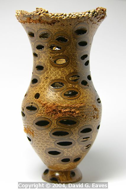

I finally got round to turning the Banksia nut I had bought at Christmas today. What a strange beastie to turn.. really like the possibilities with it though.
I made a vase form out of it. I'm not totally happy with the form. The base should be wider and the neck narrower I think. Part of this was being influenced by the shape of the nut. Next time I buy some I know what shape I want to look for now to get the shape I was after today.
The base section was wider by probably 1/4" (diameter) at one stage, however I was trying to turn the furryness out. With hindsight this was slightly misguided and messed the shape up a bit. I also like the effect it makes so I'm a bit narked with myself there.
The second mistake on my part was to drill the inside too large. I put a 30mm forstener bit up it. At the time I had a different shape in mind. The nut dictated to me the shape a bit and I went for this form. As mentioned above the neck should be narrower I think, I was limited by the internal diameter I had given myself though. I took it to about 1/8"-3/16" thickness with the open structure I didn't dare go any less than that. Its hollowed all the way down and I really like how the light shines through.
The piece was sanded in the usual manner sealed with sanding sealer and a spray lacquer applied.
Here's the piece. I'd be interested to hear your thoughts on my assesment and your own ideas of how it could be improved/where it went wrong.
I really like these nuts they are very cool, in looks and finish well. One tip for anyone thinking of turning one, there is very fine fur, it may cause some skin irritation, a bit like fibre glass. I was careful to keep "dust-extractoring" my wrists to stop an build up. I always turn with a dust mask these days too.
Thanks
David

Very nice. I've turned a lot of odd stuff but have yet to turn a Banksia pod. I like that you left some of the fuzzyness. This is unique to this material. I would agree that the neck should be thinner. The shape from the foot up is nice. It would be nice to see that shape continued up to a fairly slim neck. I do like what you did to the lip however and if you made the neck too small you would have to make the lip smaller.

>David, I suggest that for a better balance, you might make the upper part smaller. Here are several that I turned some time ago. I agree, they're fun to turn.

The fuzziness is cool, I initially saw it as a problem but then liked the contrast it gave. I wanted to leave a natural bit somewhere, and decided on the rim. I do like the effect it gave. Like you say I would lose this if I went narrower, I could work on flaring it out more mind.

Thanks for posting the photo, your pots look really good. I had that thinner shape in my mind.... Being the muppet I am the hole I had put on the inside limited that :o)
I'm looking foward to getting some more pods, the place I got them from had a whole box full, and they are quite a curiosity.
