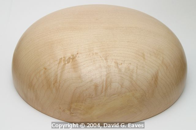

Managed to get out into the workshop last few days which was a good change. Yesterday I made a dougnut chuck (first saw it on Bill Grumbine's website, Thanks Bill). Similar to how Bill was made. I've made mine so it takes a range of dougnuts to try and make it as universal as possible. Just need to refine my bolt lengths for the sizes I have got. I put silicon sealant around the rims that makes contact for padding.
Any how, I turned a Maple Bowl today, and tried out my new chuck to turn the mounting spigot off. Worked a treat and I'm really excited by the prospect of being able to attack the bottom of bowls easier now. (Previous attempts involved live centres and just pushing against a plate in my SuperNova chuck :o)
Here's the bowl, from various angles. It turned out to be a really nice piece of Maple with good figuring on one side. Diameter is 8.5" height is 2.75". Sanded up to 600 burnished with brown paper, polished up with Tung Oil and then waxed.
Any feedback, critiques on the form is much appreciated.

>When a person says feedback welcome, I sometimes take it as a challenge, so here goes. I really like the shape and form. The inside curve seems to be of a larger radius than the outside, so I have a suspicion that there may be an increase in thickness in the transition from wall to bottom. This is not necessarily bad, actually it probably is a good thing, as the constant curve on the bottom needs the weight for the piece to sit upright. Great looking bowl...

Thanks for taking the challenge. Glad you like the form. Your observations about the wall thickness are correct. Since reading the Raffan book I've come round to the idea the wall thickness can be different. Previously I had been obsessed with getting constant thickness.
I think if I did another I would go slightly thinner at the base. Like you say it is quite heavy.. I think maybe just a bit too much. When I've done another slightly thinner I'll be able to decide which I like best.

>Great shape and it looks like you�ve got that uninterrupted curve anchored!
I understand the need for the extra weight in the bottom. Great Job.

I generally agree with you about not being obsessed about having to have constant wall thickness. Where it could make a significant difference is with turning green wood--the difference in wall thickness could lead to differential shrinkage and cracking--especially on very hard woods .

Couldn't agree more about the green turning. I've made sure I kept even wall thickness for those. As an experiment a while back I turned a small piece in spindle orientation and put various featues in it as a test. At all the sharp changes in section it cracked or warped badly. Fortunatly all my green bowls so far have just gone a bit out of round in a nice way.. no cracks yet :o)

>I like the shape, I think you got a winner here. How well does the bowl rest on the table? The bottom looks round.

I just checked how it stands on a hard surface to be sure. It sits on about an inch in the middle. It does rock a bit if you touch it. However, the weight keeps it stable and there is no way it would tip over. On softer surfaces (say with a heavy table cloth it is even stabler and probably touches over 2" or so)
I like how it rocks and the next one will be lighter in the base I think to see how far I can push it.
