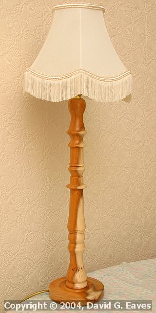

Here's some of my between centres work from a while back. The first is the unbiquitous table lamp, as I'm an electrician by trade originally it had to be done too. :o)
It was initially going to be smaller in height however I liked the piece of wood so much I ended up leaving it longer. This meant the base I had got for it ended up looking a bit small and silly. Any way I can swap it for a bigger one when I get round to turning one probably 1-2" bigger in diameter. Height of the stem is 18" the base is 5" diameter. Wood is English Yew.
Any input on the form is much appreciated.

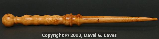

Now for a slightly more whimsical piece. One of my neighbours on hearing I was turning, said "tell him if he finds some suitable wood get him to make a fire poker for me"
Well I had another piece of Yew that was quite knotty, and not really good for a lamp. Deciding it was good practice too I set about making one and a few days after saying it, I delivered a ceremonial fire poker! :o)
Both sanded to 400, then Friction Polish applied.

Nice poker!
Mike Schwing from Md
>I like that poker! Right now I'm thinking about how I could stab my boss with it. Be a shame to get it all bloody though.
You've got me thinking about making one..and that damned flower, too. Argh.

David Eaves
>Thanks Mike,
Well if you put a laquer finish on it it might wipe clean :o)
Sorry to keep causing you problems.. I know there just isn't enough time in the day :o)

Mike Rubes
>Hi David,
That look good. I don't think the base is too small on the lamp, I think it works fine.
I like the looks of that wood, how was it to turn?
Thanks for the pics,
Mike

David Eaves
>Hi Mike,
Thanks for your nice comments. Maybe I will think again about the base size. I was hoping some more people might chip in.
Yew is a joy to turn. It is actually clased as a softwood but is pretty hard. It turns off the tool to an excellent finish. Planed cuts with a Skew bring a shine up really quickly. It takes the finshes easily. It accepts fine detail well and the contrast between the heartwood and sapwood is nice.

Don Orr
>That is really SOME spindle work! The lamp is beautiful. That wood just "lights" up the whole project. I also think the base is not too small. I think it works just fine as long as it is stable. I can't imagine poking at a fire with that great looking poker though. The clock in the other photo is outstanding as well.
Where do you get Yew wood like that? I don't think we have it here in the Northeast.
Happy and Safe turning, Don

David Eaves
>Thanks Don for your nice comments, glad you like them all.
Yew has got to be one of my favourite woods, like you say it really lights up :o) The colour is so different to all the other common woods here.
As regards the base it is pretty stable. I go between to states of thinking it is okay and then too small. I didn't glue it so I can get it out easily I will probably turn a bigger base, and see what it looks like. I appreciate the opinions here, I might well stick with that size now.
