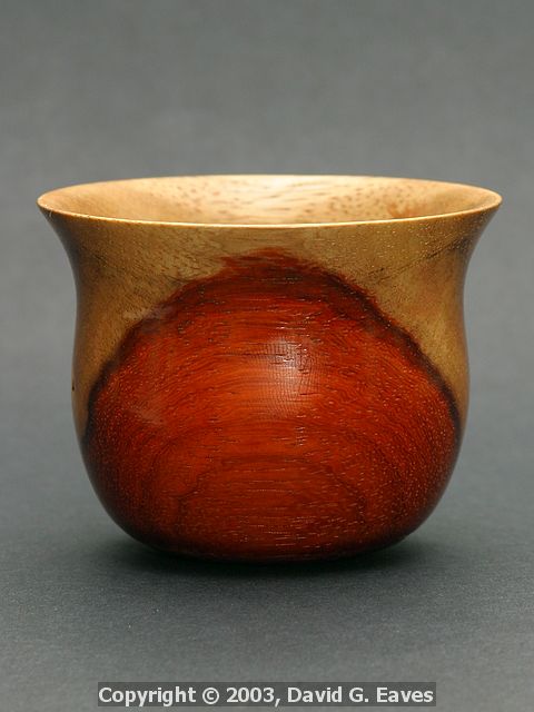

Here's a few more of my recent turnings, any comments on the form etc much appreciated.
This one is African Paduck, you even get one of my fingerprints on this. Grrr I didn't notice until I was too far away from it to take another picture. Was wet sanded to 400 and then Briwaxed.
Size is around 3" diameter by 3" tall.

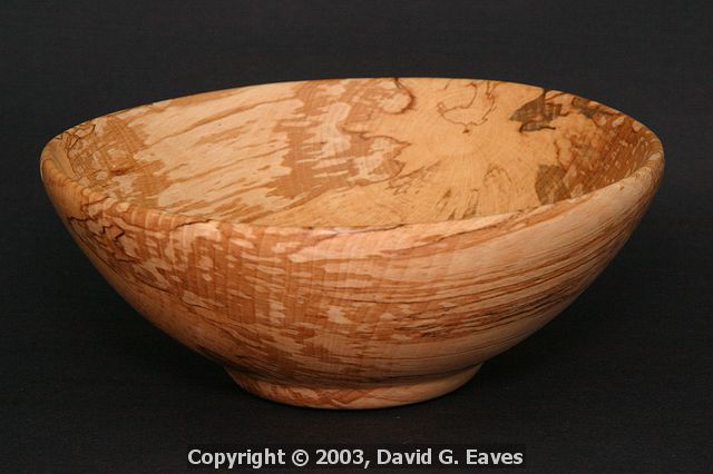

The next one is really the first proper bowl I cut from a log. A rather nice about 8" diameter Beech log. Unfortunatly I didn't get hold of it soon enough really and it had started to get shakes. When I cut it up I had to go with some of these lines. Hopefully the other pieces will dry better now. Anyway I was pleased when I cut into it to find it was spalted. The log inluded a fork, and I was a little naive about the pith at this stage, so it is in the bowl. It has started to get a small crack at the near side in the picture, but hopefully it won't get much worse.
Diamter approx 7", finish as for other bowl.
With hindsight I would have been better using a white background for photographing both of these bowls too.

On the top bowl I like the way you aligned the lighter wood on top.
On the beech, the shape has a nice flow. I like this shape better than the top bowl's shape.

>Since you asked--I would have liked the Padauk one better if the rim were a little less flared. Just my personal taste--others may disagree.

>David, the reason some folks buy and others don't is they like the features of a bowl. I like the flared top of the paduk bowl, it makes it look different than a lot of the rest that is posted. I also like the classic look of the beech.

>Thanks Ron, for your thoughts on the form. I was pleased with how the alignment of the Paduck came out too.

>Interesting thankyou for your thoughts, the range of subjective opinion is fascinating. I guess it just shows if you want to sell stuff you need to have some good variation to make sure you can appeal to a wide range of people. I will bear this in mind with future bowls and try some with a shallower rim.

>Thanks Glen, as I mentioned in the reply to David, it's interesting and shows how variation in style is needed for getting a wider appeal. I think as ever the wood ditacted me more with how it worked out as I wanted to keep the stripe of the heartwood distinct. The Beech bowl pretty much followed the curve of the trunk which I guess does give that classic profile.

>Nice job, David --
The fingerprint points out that wax over wood is not going to cut it if the piece is to be handled -- and attractive pieces like these beg to be touched !
My un-solicited advice would be to look into more durable finishes. There are many, and a lot of differing views on what's best, etc...
I like to use a cellulose sanding sealer, or blonde shellac as a base layer, then a very light coat of wax as a polish for "pretty things" -- those that aren't really functional, but meant to be admired.
For functional stuff, I've had good success with Urethane Oil, which can be shiny or dull, as you prefer, depending on how you use it, but its very tough, and good for utilitarian bowls.

>Wax works best when it is a THIN coating, and the thinner the better. The fingerprint tells me that it is neither.
Buff the wax with a stiff brush rather than wiping it with a rag while spinning the wood in the lathe. A stiff scrub brush or a stiff shoe brush would be a good brush to use.

>Thanks for you input on finishes Brad, very useful. I'm not sure if the finish is to blame though. I think it might just be a greasy print rather than into the finish. I haven't got it with me to see what it's like now.

>Thanks Russ for your tips on the wax. As I just mentioned in the reply to Brad, I think the print was just a greasy mark rather than into the finish. I'm not certain though. Next time I use the wax I'll follow your advice and make sure it is thin.
