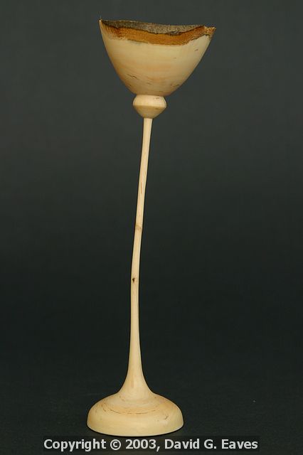

>Hi there,
Here's a slightly different turning I had a go at. I first saw these in a book, and thought at the time.. why on earth would you want to turn something like that. :o)
Anyway, a few months on I realised what an interesting challenge it would be. This was turned from Hawthorn branchwood in the green. After turning and finishing the head, I worked down the stem about 3/4" at a time, finishing each section. I sanded to 400 and applied a friction polish. Amazingly I got to the bottom, without diaster. I did have to add CA glue about half way down as there was a small knot which was looking weak. This photo was taken a week or so after turning when the wood had dried out a bit and started to distort.
The stem at it's thinest point is about 2mm (0.08") at the thinest point. Height approx 6", flower diamter 1.5".
It was great fun to turn, if not a little nerve wracking and seems a good use for branch wood, along with mushrooms.
Does anyone else turn these sort of things.. how thin do you dare go?
David

That is awesome! That is a great use for branches. I like the way it is starting to lean as it dries, makes it look more "real" somehow.
Neat stuff,
Mike

Thanks for your reply, glad you like it. Like you say the bending adds some extra realism.
I've got loads of branchwood, so it should keep me busy for a while :o) Let us know how you get on with yours.
I guess everyone else round here is more into bowls and vessels, as nobody else has chirped in :o)
David

>I think its neat - and I'm not into perfectly round necessarily. In fact, I have an idea for your next one - carve/cut petals into the flower. Tulips come to mind, of course.
A very light wash of red dye on the petals would put them right into bloom, too.

>O.K. it's early and I have only had one cup of coffee. Is that all one piece or is the "bud" seperate?
If it is all one piece, how do you keep it that way when starting and stopping the lathe?
Very nice work as usual, David. I have looked at that Idea but not tried it yet.

>Thanks Mike, I really like your carving/colouring ideas, I will have to try that. I got to thinking I could make a few of them and put them in a vase too. I will get some red dye I have seen some by Chesnut products that would fit the bill.
Thanks again
David

>Hi Tom, thanks for your nice comments.
Yep it's one piece. The way I approached it was to turn the flower and bud detail, then finish and polish them. I then brought a live centre with soft padding in to support the flower. The next stage was where it got fun, I worked down the stem in short sections sanding and finishing. I think I avoided stopping the lathe much especially when it was getting long. I probably used my hand to steady it to stop in flexing when it started I can't quite remember now. I'd certainly recommend it for the challenge.
Thanks again
David
