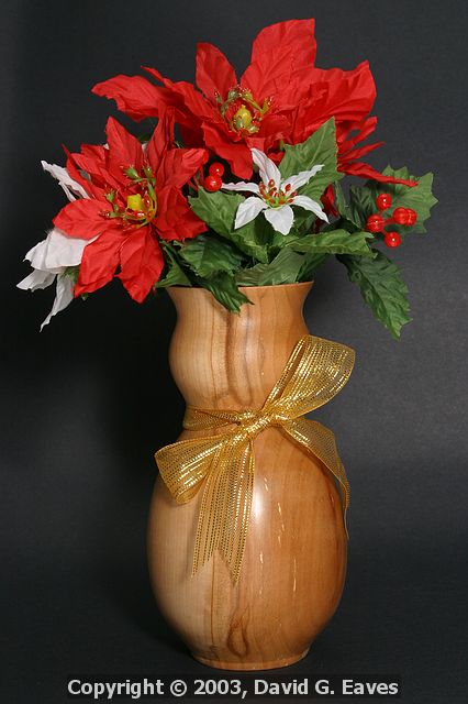

David Eaves
>Hi there,
Below is a picture of a vase I turned from some Apple wood over Christmas. It is about 4" diameter, with a height of 8".
I'd be interested to hear comments on the form. Sorry the ribbon obscures it slightly. After finding its way in the house it soon became functional. However, it does I guess show it meeting it's purpose.
One of my thoughts after finishing it was it had ended up looking like a snowman! :o)
Please note I'm not being funny with the copyright it just refers to the photo. I've ended up marking most of my photos online as people have kindly nicked them in the past.
David

Mike Rubes
>Hi David,
That looks great, thanks for the pics. I think it sort of does look like a snowman :) I think it's good that it is already found use.
I'd be curious as to any information you could provide about turning the apple. I hope to get a few chunks in the very near future and having never turned any, am wondering about drying it without cracking, any suggestions for finish (yours looks great), consistancy as it turns and any other information you might could provide?
Thanks for the pic.
Mike

David Eaves
>Hi Mike, thanks for your comments.
Okay apple wood. Well I cheated on the drying as they were bought blanks. I have been reading up on the drting process as I have two apple trees lined up to harvest in the future. As I think you've probably guessed it would seem a trck one to do from distortion and cracking. I read somewhere a 50% yield was considered good. I know I turned a bowl out of it, and the blank had ended up all shapes. I'll find the information later I've got on drying tips for it.
Turning wise it is a really nice wood, holds fine detail well. It does turn dusty. I also think it is quite a brittle wood, when considering chucking. The end grain cuts well and deson't tear much. I bit a lot off hollowing this out mind as it is quite hard work, as it is a very hard wood.
Finish wise I sanded to 400 and Bri-waxed it, it seemed to work well. I have also used liquid parrafin based finishes on it. They did okay but didn't darken it more than other woods.
All in all I find Apple a good wood to turn.
Hope you have sucess drying it.
David

Mike Schwing from Md.
>Very nice David. Beautiful sheen on the work.
Mike - to address the apple a bit, I've been turning a lot of fresh cut apple (working on getting more to satisfy those I've promised to send some to, but the weather has been horrible for cutting up trees lately). Based on numerous pieces of good advice I've so far had absolutely no problems. I roughed out the pieces to about 5/4 thickness and anchorsealed, lightly the entire bowl. Put them in paper bags or newspaper and sat them on the shelf, checking them nearly every day for a couple of weeks - not a single crack. They're down to at least half of their original weight, which is substantial to begin with, that was some wet wood. I have taken them out of the paper and they're sitting on the drying shelf. They still smell like fresh apples but there are no cracks and very little if any distortion of shape as of yet.

Mike Rubes
>Hi Mike,
Thanks for the drying information.
It's been unseasonably cold down here in NC as well. It's the middle of January and I am already waiting for Spring!
Thanks,
Mike
