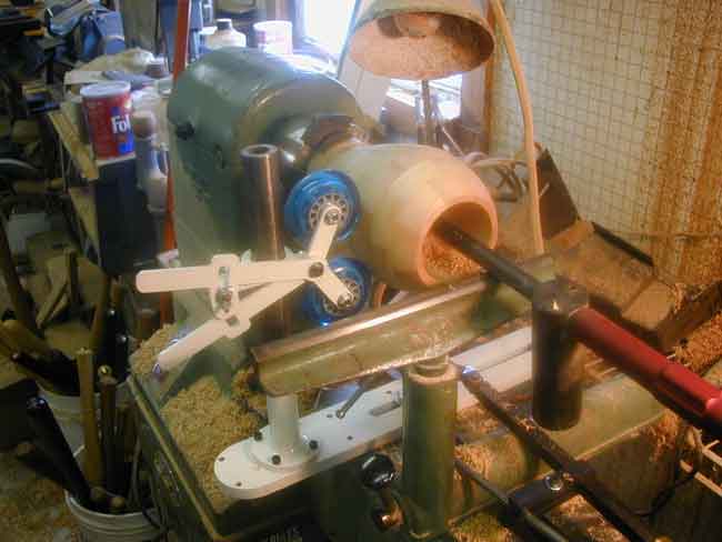

>My General is a 1987 model which started out as a 12" swing with an outboard tool rest. The reeves drive belt has been replaced. This was necessary when I put the 4" riser kit in. Because I had an outboard tool post I was able to use it on the regular bed. I do not have a gap filler piece, there has been many times I wish I had one. The rear nose of the spindle is 1 1/8" x 8. My machine is non-reversable. I frequently lube the reeves drive to keep it from squealing. My orginal magentic switch was disabled to keep it from turning off when in use. The tailstock does not hold well and never did. At least the tailstock will let you eject the morse taper. There is some druming and noise with the drill system and cabinet. The Delta variable reeves drive is more noisy than the General. At the time of purchase I believed it to be the best heavy duty machine available. I still use it occasionally for roughing out. A year ago I upgraded to the Vicmarc 300 and have never looked back. I would still druther have this old General, which will last another lifetime than one of the China clones. Showing a pic of the Kelton system and Oneway bowl steady on the old girl.
