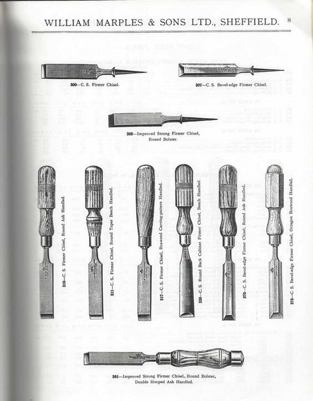

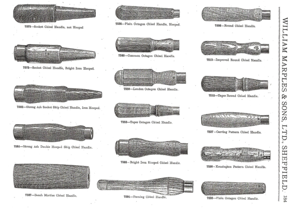

Let's take the chisel handle design used by David. The first evidence I can find in a Marples catalogue dates - and this was not yet the same design, just appears the forerunner - was 1903 ...
The actual chisel handle was defined in 1909 ...
Marples began making chisels in possibly the 1840s. There are chisels marked HIBERNIA in 1875. The Boxwood versions (as per David) probably started in 1954 and were offered in Ash as well. The Blue Chip versions were produced in 1968.
In short, this style handle is fairly recent in the history of chisel handles, and represent just one of MANY styles. The earlier styles, which you decry as designed by nincompoops actually are the style preferred in the period you deem to be most relevant in our woodworking history!
As for Veritas handles, since you point fingers specifically at Veritas ... why - no one raised them for comparison? ...
Top is Veritas, bottom is LN/Stanley ...
... while acknowledging that one man's meat, etc .. this is a chisel handle that I consider to be excellent in my hand ...

Charlie, I know.
I could have referred to a number of other makers, but picked on Boxwood Marples because they are the chisel-of-choice of David's mentor, George Wilson.
Re: A David Weaver Chisel
I had no idea....
how many styles of handles there are, and I suppose your picture is not comprehensive. Thanks for the picture
