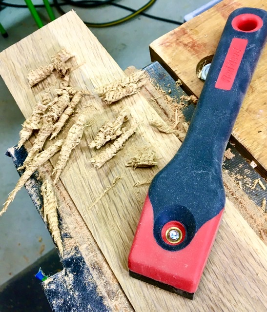

I am a dilettante and can’t vouch for the usefulness in real work but this photo shows the curls that come off of white oak. My thumbs would have been on life-support had I used a card scraper. Today I flattened the back of the blade on a diamond stone and repolished the bevel before turning a burr. I put the back of the tool on a surface to support it and used some mineral oil to avoid galling before applying pressure on the burnisher. I may not be able to do this again so I wanted to show off.
Winston- the sound is awful at times but can be mitigated by pressing one hand directly over the blade, pressing down while pulling with the other hand. In my limited experience, a really good burr makes no squeal.
