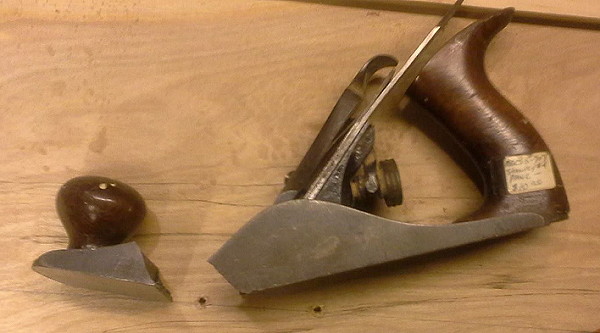

Thanks for all the comments! I realize this sort of question is in many ways unanswerable beyond "It depends..." My own usage of hand planes involves an old wooden antique smoothing plane-@18 in length, a Record #5 jack plane , an old No 4 1/2 Stanley Plane and a small unnamed block plane I picked up at an Upper Peninsula Michigan Home center last summer. About a month ago in a klutsy move I knocked the no 4 1/2 on the floor and destroyed it.
Till that point my main usage was the Record and the Stanley-I had the Stanley set to remove a slightly thicker shaving than the Record- My use is usually planing furniture joints or glue-ups as necessary- overall I don't do a lot of major surface planing-truth be told I just as often reach for a chisel-1/4 1/2 or 3/4 and "drag" it across surfaces as a scraper-Unconventional usage I suppose but I can See the material being removed and have developed a good feel for the pressure and angle required for these situations. This technique works especially well in smoothing inlays-after they have set but need the glue and slightly elevated height of inlay material removed and flattened to be level with the background surface. After reading these comments and doing some extra other searches I am convinced I could become a "plane guy" if I dedicated my budget and would soon wonder how I ever got along without some of the styles and sizes I don't have.

Terrible luck about that 4-1/2 :( . I suppose one option for you is just to get another 4-1/2, although the Stanley ones are pretty rare in good condition like yours was.
