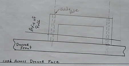

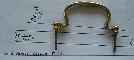

Bill Tindall
This picture shows a pull similar to the one I will be using. The pull is laid on a diagram of the bow front drawer looking down on the top edge of the drawer. The front and back surfaces of the drawer are shown as well as the axis defined by the drawer pull and its posts. What could be described as the "cord" across the width of the drawer is shown at the bottom (chord here is like the chord of a circle except this arc isn't a circle).
This picture shows what I think will be a "C" shaped drilling jig that will work to locate the post holes in the drawer such that the posts and bail all line up on one axis. The holes in the posts for the bail as well as the pins on the bail ends must define one axis or the posts bind.
I did note that one catalog suggested calling for instructions if these rosette pulls were to be installed on a bow front. I would have ordered from this company except they didn't have the bail I wanted.

Hi Bill
Two options:
1. Drill a slight recess/mortice for each leg so that the ends are bedded.
2. (my preference ..) Heat the brass and bend it to shape (carefully!). Test this out on one first.
