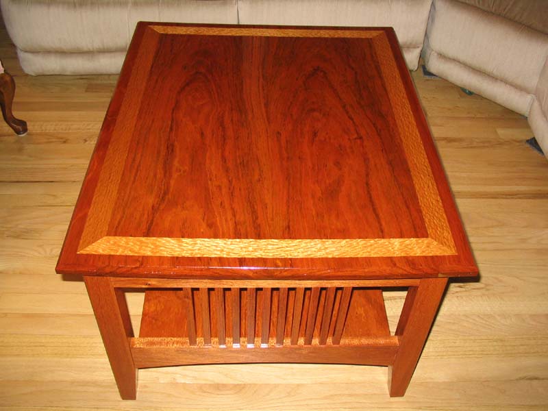

Re: LV Bevel Up Smoother - a review *LINK*
Greg Sloop, Portland Oregon
>My table worked just fine. The top was easily handled. It's not super figured, but it shouldn't be a problem. Are you sure it's still sharp? Jatoba really has a lot of silica in it and it hammers the blade pretty hard. I had to sharpen fairly often.
But the BU LA Jack worked wonders for me, especially on the lacewood.
More here if you're interested. (The top was flattened with a LN 62, which was then traded off for a LV 62.5 (LA BU Jack) which handled very similar stuff with at least as much aplumb, if not better.
Cheers,
Greg
http://www.sloop.net/lisatable/index.htm
Jatoba and Lacewood "coffee" table.
