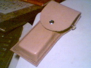

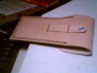

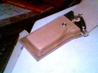

>In the past there has been some interest in leather working among the woodworkers here so I thought I'd post a few pictures of the holster I made for my new LV Medium Shoulder plane.
It's pretty plain right now - but I'm thinking of adding a bit of design work to the flap - something in the celtic style I'm sure. :) I'm not nearly as experienced at leather working as I am at woodworking - but it is fun. (not to mention a whole other set of tools to coll......., er, use.)
I don't have a lot of space in my "shop"/utility room so it's nice to be able to hang things in odd places. I even added a belt loop on the back so that it would be available for a "quick draw". Actually I don't anticipate ever putting on my belt - but it was easy enough to add the loop, so I did.

>Hi Skip -
First off, let me say that the holster looks absolutely great! After seeing Bob Smalser's tutorial on making a leather holster for his pocketknife, et. al, I've been giving it some thought myself.
My only question has to do with the particular plane you decided to holster. It's a shoulder plane (obviously) and as such the blade should project from the side of the plane body by some small amount. As a result, I was wondering if the rubbing process caused by taking the plane (and its blade) in and out of the holster might not abrade or dull the crisp edge on your blade - making it somewhat harder for your plane to do its job of getting into corners.
Don't really know. Just a question. Don't intend to detract from the fine workmanship exhibited in the holster. The holster looks very cool!

Skip in Falls Church
>Hi Dave,
Thanks for the compliment - I don't do leather working nearly as often as I do woodworking - but I find it fun. If you're thinking about trying it - I say go for it. :)
What doesn't really show up in my crappy picture is that in the molding process, both edges angle outwards so that the blade doesn't come into contact with the leater. I don't think it would cause a problem if it did, the holsters I made for my block planes allows the blade to come in contact with the leather and I haven't seen a problem with them. When I made up the holsters for them I thought about putting a piece on the back at the toe so it wouldn't come contact the leather - but decided to just leave it. I do glue a leather "button" over the metal base for the snaps on the inside so there won't be any scratches.
