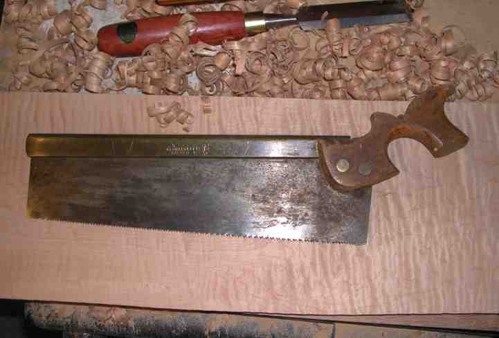

>Fettling a saw is pretty easy... it is not as a Herculean task as you may think it to be. Especially a rip saw.
If you can sharpen a chisel or a plane then a Rip saw with few tpi is slam dunk. No worries regarding turning burrs, mirror polishes, flat soles, flat backs or cryogenics!
I would encourage you to read up on how to sharpen a saw at VintageSaws.com. The articles in the library explain how a saw cuts and how sharpening changes can affect a saw cut.
Sharpening is a skill that you you would eventually have to do with a saw regardless of age. The secret to ripping fast is to keep your saw sharp. So it is a skill that will prove to be valuable. (I personally don't have the patience or the money to send saws away whenever I want them touched up.)
In terms of time invested in tuning a user rip saw I would see no more than 30 minutes for sharpening and setting. I mean it is a rip saw after all and small imperfections will actually improve its abilty to cut. (Afterall, my favourite is missing several teeth to no ill effect!)
Personally, I would rather buy old saws as I can buy many and experiment to find the one that I like the best. (I am not a collector!) Posted here is a before picture of a beat up saw...
Re: Ripping by hand.
and After, with Saw ID ?
Brad in Ottawa
>Here is the after picture... Many people passed over this saw before I got it for a song. Broken handle and a bent brass back. Two seconds in a vise, a quick sharpening, and a new handle produce a great Back Saw.
Hope this gets you to reconsider! (If you want some help I will gladly offer any assistance/coaching!)
Brad
PS - The saw is stamped GEONARLOR & CO Sheffield, does anyone know about this maker?
