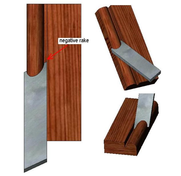

Negative rake dilemna
Sandor in Boyds, MD
>I'm guessing that they never made beading cutters for the #46 due to poor cutting geometry at the inside edge at full depth. You end up with negative rake due to the skew angle. In a #45/50 etc. you end up with a 90 degree scraping action, but with the skew, the angle is less than 90 and you won't get a good cut. This is in theory though. I'd love to test it out. Perhaps one could raise a burr on the inside edge, thus turning that portion of the profile into a scraper blade? Any mad scientist woodworker machinists out there? Here's your calling....
