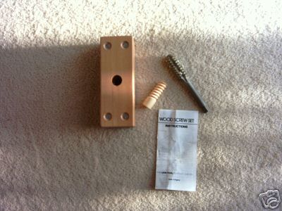

>I have bought a couple of wood thread cutters made by the Lion Tool Company in England on Ebay.
Any photos, either from you or Ebay? I've not heard of this company.

>Here's one off the Ebay page but it's not that great. I don't have a digital camera so this will have to suffice.
The die works beautifully out of the box. Considering how well this works I do wonder why the need to use a router to cut the male thread with the Beall kit. Perhaps if you're making a lot of threads it makes sense. I don't know.
