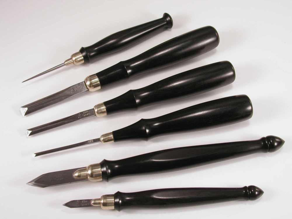

Chisel Pix? *LINK*
>Could you post a picture here of the dovetail chisels?

Re: Here are some pics...
Mark Meier (Ann Arbor, MI)
>Here are some pictures of the great tools Dave made for me from African Blackwood.
They are part of a set:
Mark
Re: Tool Review
>Very nice! Have you had a chance to use the chisels much, yet?
BTW, is that a regular awl, or a scratch awl? ;-)

yes!
dave jeske
>It is one or the other :)
This is a pic of a set including the infamous "awl". I call it a scratch awl.
Dave

Re: Tool Review
>I've done some practice dovetails with them. They are really sweet.
I usually don't use an awl to scribe a line. I'd rather use a knife or a pencil.
Mark
