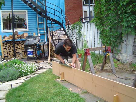

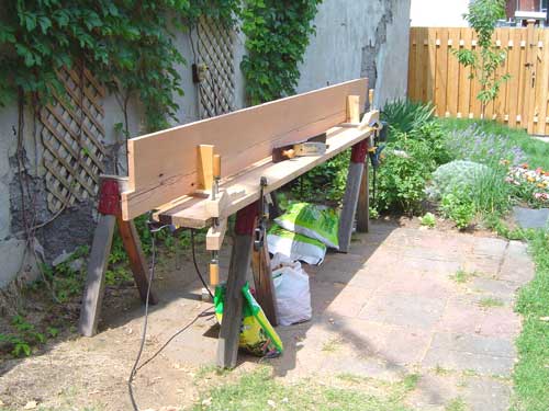

Re: HIJACK: Planing height?
Frank D. in Montreal
>Hi Don,
Don't you know that us French-Canadians are shorter than you Americans?
The long version is that the board in the pic was the widest of a series of boards I had to joint. My workhorses are around 35", plus a 2 x 10 on top, plus the 18" board and the holders, that made the planing height around 55", a tad too high for me. I'm 5'9", and I prefer to work low (my bench is 33" high--low...), so I did that board on the ground. I did the other ones on my workhorses though, they were around 12" wide.
Don Thompson, Cutler Ridge, Florida
>Well, you are taller than me. I am about 5-foot 8-inches.
My back hurts just looking at that setup.
Paul M. in San Diego
>Thanks for the description. I had this image of you doing the Chuck Berry duck-walk along that board while jointing. ;-)

Re: Opinions - Please
Alright alright...
>Here's one I salvaged from the trash...flex those knees!:)
Ahhhhhh...... better.
>BTW, nice little urban yard.
