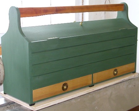

>I have been working on this toolbox and it is mostly done except for a few refinements. It is made of pine (western white?) to save on weight. The handle is cherry and the drawers are sassafras. Growing up this is the shape of box my dad and other carpenters used to carry some of their tools and this is what influenced me. I added a hinged top that I attached tools to and would keep the dirt out.
The bottom is dovetailed on and the inside 'floor' is through tennoned to the two sides. The front and back are made of tongue and groove strips about two inches wide to mitigate cross grain movement to the sides. The front and back are tennoned and pinned to the sides. The empty box weighs about 15 lbs. I plan to add a brass strip to re-enforce the short grain where the handle tennon passes through the sides.
My goal was to be able to reach any tool without moving another. I mostly succeeded with a few exceptions. To get to my #7 jointer I need to lift my hatchet, tack hammer, mallet, and box of augers. I am working on a cradle for these four items so that I may lift them all together with one hand and grab the #7 with the other. The other goal was to have a fair selection of tools to be able to do a wide variety of woodworking tasks. I think it will be an on-going evolution as I add or subtract tools.

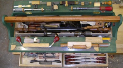

>All these tools fit into my toolbox. Not seen in this picture are a 3x8 fine india combo stone and a 2-1/2x6 hard arkansas stone. The hand saws are full size 26" rip and croscut with two 12' back saws. I am looking to fit a dovetail saw and maybe a turning saw instead of the coping saw.
The chisels, gouges, file,and rasp fit in one drawer. The sharpening stones, hand beader, and 043 type plow plane fit into the other. I plan on adding auger and saw files to the second drawer.
The toolbox and all these tools weigh-in at 60 lbs. I don't think I would like to add much more weight!

>If you're still with me, a view with the toolbox loaded. It is heavy but still manageable. My tools do not live here permanently; this is supposed to be a travel box. I don't think it would survive bouncing around in the back of a pick-up it is built too lightly to conserve weight. With reasonable care I think it will last a while. I have been working out of it for a month or so and I am pleased with it.

Todd Hughes
>Very nice looking box....the only thing i would be worried about is that the drawers could slide open and fall out when you lift the box and move it around.Maybe you have a way to lock them shut and I missed it. A sliding front like you see on Machinist Chests would be the classic way to do it I guess....Todd

Re: Drawers
Paul in NJ
>I attached rare-earth magnets to the back of the drawers and they do a fair job. I thought about various means to secure the drawers but the magnets turned out to be the simplest if not the most traditional.
