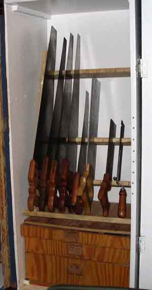

Bob Hutchins in central Texas
>Because I posted here awhile back asking about this, thought I'd show what I wound up with. It's not finished yet, but you can get the idea.
The cabinet started life as a tool chest in a different shop where I had more space. I turned it on end, put it's twin beside it (not shown; tailed apprentices live there), and mounted them both on a 2x4 base that houses my compressor. The whole takes up less than 6 square feet of shop space. The boxes are 3/4" BD ply and the drawers 1/2" AC. It was all stock I had to use up or toss before I moved.
The door/lid (barely seen at right) will be hung with various and sundry hand tools. The drawers (fibonacci in proportion) contain brace bits, wax, pencils, and sundry odds and ends. Hand Planes will rest on shallow shelves behind the till which will pivot at the top to allow access to the space behind.
Thanks for looking.
BobH

>The last saw on the right, with the cranked handle, looks like it might be used for cutting plugs flush, and appears to have a reversible blade. Shouldn't the brass nut be on the top side instead of on the bottom side?
Re: Saw Till
You Are Correct, As Usual, Sir William
>This is actually the poorest saw in the till and the one I use to make quick and dirty cuts on all kinds of stuff. I rarely use it for flush cutting and must have stuck the bolt thru the wrong way the last time I used it. I'll fix that.
Thanks,
BobH
