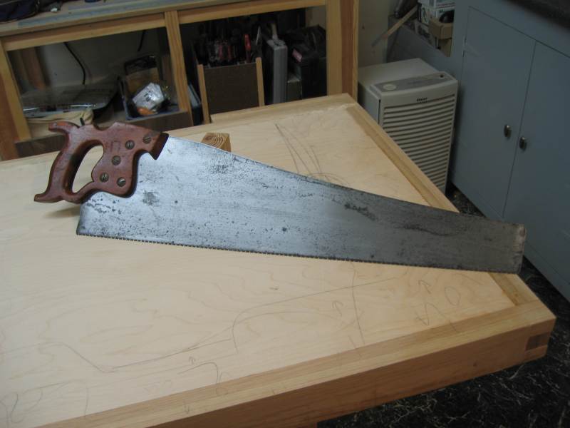

>Well after reading the directions from Pete Taran on cleaning a saw, I applied some elbow grease and other things in order to clean up the saw.
Attached is the original picture as well as a link to the page.
Responses will contain images of the cleaned saw.

Christopher Fitch @ Memphis
>just about...
I started with 220 grit...and rubbed rubbed rubbed.
Then I switched to 320 and made a few passes.
I cleaned the handle screws with some Brasso but it made little difference.
Finally, I did some *light* sanding on some of the rough areas of cracked finished. Not much but just enough to smooth it out and then applied the BLO.
>Following along the data from the Disstonian Institute, I know the saw was made between 1917 and 1928 from the blade etching and the medallion.
>Alas that's not writing from my son...
That's my scribbles marking the low and high spots still remaining on my unfinished bench top.
One of these days I'll finish flattening it and put a finish on it...
one of these days...
