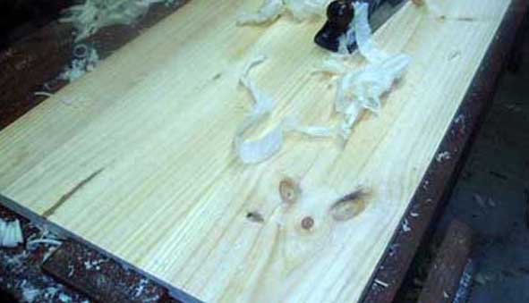

>I built my bench with the traditional square dogholes originally. However, over the years I found that these did not really suite my needs. So I drilled the top for round dogholes, finding that these are just so much more practical and versatile.
I use 3/4" inch jarrah dowels as the basis of my dogs (this size is the same as those used for the Veritas accessories). These may be used as-is or, as I prefer, set into a rectangle of timber. Make the rectangles of different sizes (both length- and depth-wise), and you can accomodate different thickness of timber against it. I have included a picture below of one in use (bottom left side - unfortunately you can only see the top, but there is a dowel that drops into the bench top. My apologies for the quality - clipped pic from a recent posting to the site).
The advantage of this system is the the bench dog can rotate slightly to accommadate to off-square timber. Also you can add the Veritas Wonder Dogs at the other end (makes a versatile end vise system).
Not traditional but it works for me in my cramped space (bench up against the wall in a garage-workshop).
