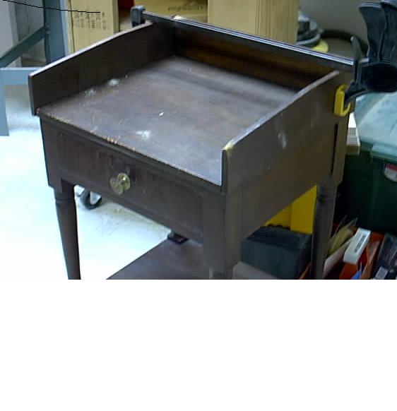

jim_reed@marietta
>Today's project was to make a new side piece for an antique washstand. Original was broken off and lost. The piece is a Sheraton/country style piece from about 1840. It has maple legs, a walnut veneer drawer front, and poplar top & shelf. I got some poplar, cut it to length (plus 1") and split it on the bandsaw to 5/8". Got out the LN scrub and scrubbed it down. Finished up with the trusty #7 to make it a flat 1/2". It tapers from the front to about halfway back. Made the cut and finished surface with #7 (how would you do this with power tools? jointer? router?). A little stain later and this bad boy is ready for some glue. Can you tell which one I made?
Re: Today's Project
Re: Today's Project
Alan Bierbaum
>Neat work. Hard to tell from the small photo; but it appears that you made the left side piece.
Re: Today's Project
Re: Today's Project
jim_reed@marietta
>U R correct. I guess the cat's chew mark on the right side gave it away.
Re: Today's Project
Jim in Burlington Ont.
Nope I can't tell
Jim in Burlington Ontario
>But it has to be one of the sides.
Re: Today's Project
Re: Today's Project
>You asked how you would shape the top of the side with power tools, I think. There are two ways I might do it: Both involve making a cut close to the line with the bandsaw. In this case, it would be almost as quick to do it with a rip panel saw. Then, I would smooth out the cut with a jointer. Again, since it is such a short cut, using whatever bench plane happened to be closest at hand, and sharp, would be just about as easy. In this case, I think the #7 would stay on the shelf, because it's a little too heavy. Smoothing the transition and breaking the edges is definitely a job for hand tools: I'd probably use a file, followed by a block plane and card scraper. Of course, sand paper would work, in a mostly power shop.
Re: Today's Project
Pretty good
jim_reed@marietta
>I think those power techniques would work well. I was just struck by how appropriate the plane seemed. The final piece was only 1/2" thick and 4 1/4" wide at the big end. I just shuddered at the thought of running it thru the jointer (sooo close to those spinning blades).
Re: Today's Project
Re: Pretty good
>That's why lots of knuckle-draggers call the bandsaw their "Neanderbuddy" -- it's one of the forked-tailed apprentices that gives the least offense, at least when properly tuned.
Re: Today's Project
Re: Today's Project
Roy from Cincy
>Jim
What kind of stain did you use? How hard was it to match the color?
Re: Today's Project
Got lucky
jim_reed@marietta
>I am no stain genius; I just got lucky. Swiped it down with Special Walnut Minwax and the tone was perfect, just not the right shade. I followed that up with a swipe of Red Mahogany and it matched perfectly. Given the choice of being smart or lucky, I will pick lucky anyday.
