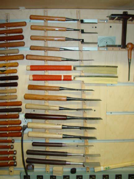

>I think any chisel rack out in the open will display your tools and provide some organization. I chose to use a rack similar to what you saw in Odate's book, except I wanted it configurable for various tools. It's simple and functional. Only took a couple hours to make and the tools are right in front where I can grab whatever I need.
The 1" x 3/4" pieces are drilled for 1/4" dowels and mounted to T-track embedded into the 3/4" birch ply using 1/4" bolts and nuts. The nuts slide into the T-track. That makes the dowel peg boards movable to accomodate different size chisels. I can make the pyramid shape you saw in Odate's book or just angle one of the peg boards as in the picture. I can also mount the peg boards horizontal for other types of tools. You can see in the upper right corner a marking gauge that's sitting on a peg board mounted horizontally. Not all of the T-track is being used. I mounted it in various places to make it configurable in case I ever want to change the positions of the peg boards.

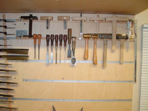

>Here's a pic of the peg boards mounted horizontally for other tools. The only difference from the vertical mounting is a third 1/4" bolt in the center to prevent flexing.

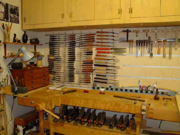

>Here's what the overall workspace looks like.

>That's a beautiful selection of tools. My brain would short circuit trying to figure out which one to select.

>Western bench and planes (hidden below the bench) and great selection of Eastern tools on the wall. Very nice work area. Why this mix of tools?

>A Japanese furniture maker will do most of his/her work on a bench low to the ground. My back can't deal with that. That's why I prefer the western style bench. Their working style is different. Occasionally, they use their feet to hold the work. Recently, I had the opportunity to meet a shoji maker named Mr. Watanabe. Right before a demonstration he was asked if he wanted to work on a western style bench. His response was "No, because then I can't use my feet." Very skilled craftsman. Hope to take a course from him next year.
As far as the planes go, most of the time (when in the mood to use handtools) I still prefer to dimension lumber with western planes. I use my Japanese planes mainly for smoothing softwoods and some hardwoods. (I'll admit for most of my dimensioning I'll turn on the power tools.)
As far as chisels, I don't know. I still use both. Lately, I've become attached to my LN bench chisels.
