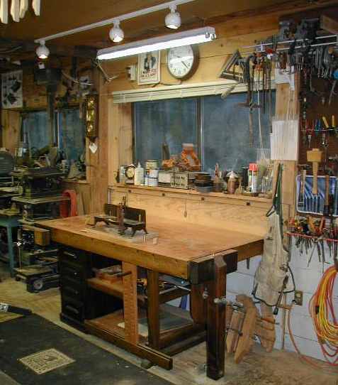

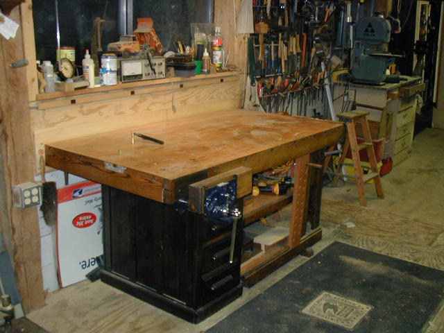

>Up until now I�ve posted picks of my dump finds that took little or no work, with the exception of the saw till. Here is the bench I made for pieces I found at the dump.
The top is a 1 3/4� laminated Maple table top originally 3 x6', which I beefed up with 2 x 12s (BOUGHT) giving me a 3" thick top. I had to rip the top and cut out a section that was separating and could not pulled back together.
The shirting around the top is cut from a piece of 2 x 10" x 10' rough sawn Oak plank I found. Lacking a Jointer and planer I surfaced it with a #6 after cutting it down to size.
The legs on the right side are Oak from an old table. I cut the taper out of them leaving them at 3 1/4" square.
The shelf supports were cut from the Oak plank above. The shelves are 3/4" Maple plywood also from the dump.
The drawers are from an old Oak Pedestal Desk that had to have the missing pieces replaced and the hold thing torn down and rebuilt to give it more strength.
Each of the boards in the top were badly cupped. I used a a good straight edge and some blue chalk, I cut down the high ridges with the #6 until I got it close and then finished with a ROS. Flattening the top took about a week. It's close, I won't want to try to plane thin pieces on it but it works. I put a Bees wax and thinner finish on it that took way too long to dry.
I drilled the dog holes with a jig I built to hold a Zyless vise in a drill press arrangement.
I've got about $50 dollars into it at this point for 2 x 12s, lag bolts, stain, finish and screws. I added a Knock-off Record vise, hold downs and Dogs from Lee Valley, now I'm over $200.
continued in next post...

>The Vise on this end was one I built for the table I used as a bench before this and with little modification works well here. It needs to be counter balanced with a piece of equal thickness when cutting dovetails or other uses when only using one side of the vise. I added a thickness adjuster on the floor. Cost a 3' piece of 3/4" threaded rod and a 1/2" pipe "T".
The power strip on the wall and the Track lights are also from the dump. I did buy 3 new 50w lamps
It did take over a year to collect all these pieces and it was the drawers that put me over the top and got me going to build the bench. Total, somewhere around $250
The picture were taken in my old shop. It was a pain move but it safely made it to my new, well heated shop.

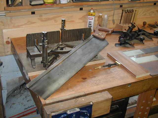

Is this your primary bench, or just a workstation for planing and whatnot? I especially like the leg vise, but the sliding board slave is a nice added feature and I'm sure that it is handy. I built by board slave right into the bench by making the top skirting out of a 2x8 and boring holes in it. Has worked well so far, but I no where near the depth capacity that you do.
What make and model is your miter box? Is that a dump find also? No wait, don't tell me, I don't wanna know, no really la,la,la la, I can't hear you. ;~)

>It is my primary, singular and only one right now, but I have a new collection of recycled hardwood.
The box is a turn of the century era Millers Falls, Langdon Amce, size 2 1/2 # 73 with a 26" Disston Backsaw and take a breath T. O. "It's NOT from the dump". My nieghbor gave it to me for some work I did for him. Of course he found it in a Flea Market for $25, not much difference.
