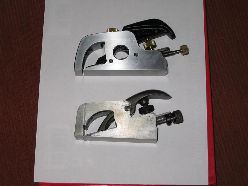

Christopher Fitch @ Memphis
>Well, I trudge back to work...and in the afternoon I receive a package! ...and have my fellow employees make jokes about me.
Too bad for them they can't take the following pictures...
In this series, I show a number of pictures comparing my new Veritas bullnose and my Record 077.

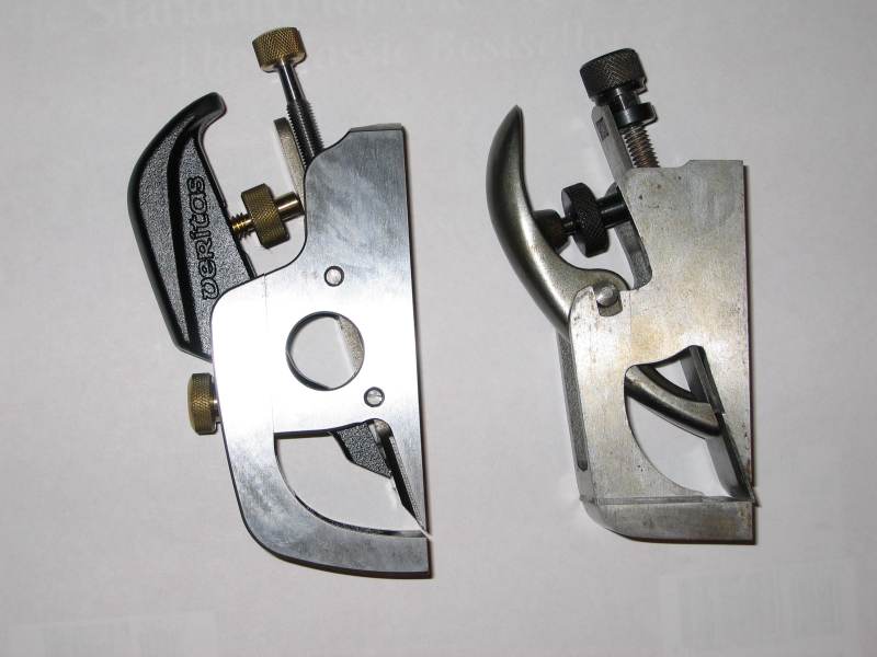

>Another image...
>Another...
>One more...

>Thanks for the photos, Chris.
How about some shots of them disassembled? Looking at the photos, it appears that, although they are at first glance almost the same, there are substantial differences.

>Hi Chris -
Congratulations! Great looking planes, and nice photos, too.
A couple of questions: if you already had the #77, why did you get the Veritas (not that anyone on here on WC has to "justify" a plane purchase), and the photos of the Record suggest that the toe can be removed so it also can be used as a chisel plane. From the photos that it doesn't look to me like that's true of the Veritas. Am I right or wrong?
Enjoy the planes! On what kind of a project do you anticipate first using the Veritas?

>Furgher, it appears the Record has a removable, and perhaps replacable, plate between the nose and the body, which would allow adjustments to the width of the mouth. Is that correct? Is there any play in the Record's nose mount that could possibly cause difficulties in aligning the nose with the body?

Yes has both adj mouth and works as chisel plane
chad pearson
>I just got the veritas bullnose. The front can be removed so that the plane works as a chisel plane (secured by the knob on the top). The same sliding front is referenced by a recessed screw. This allows you to adjust the throat opening with significant precision. It is a nice piece of machining.
No affiliation... blah blah
Chad
>Further, it appears the Record has a removable, and perhaps replacable, plate between the nose and the body, which would allow adjustments to the width of the mouth. Is that correct?
Actually it has 2 shims that you can take out. Planecraft covers the thicknesses of the shims. I can't recall what they are off the top of my head.
I have not seen any that would cause issues. It has a stud in the front that helps align the nose ans shims.
