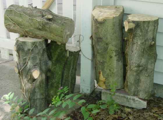

>Saturday I (with the help of some neighborhood heavy-weights) cut down a holly tree that was too big to be so close to my house by hand with a 21" bow saw and a hatchet. The trunk was nearly vertical and about 8" in diameter at the base. There were very few sections without lots of branches. I did the 'cutting up' on my own yesterday. The wood seems harder than I was expecting from an evergreen.
So, I have a few relatively 'branchless' sections -- a total of about 4' in length and a bunch more with lots of branches (see picture below) -- about 20 feet total. I cut the branched sections into 16 to 18" pieces. Do they have any use? Can someone use them for turning? Are they just firewood? I am willing to give them away. What's the best way to handle my little 'branchless' sections? I've removed the bark from the biggest one and plan to do the same with the other two little ones. Will any paint do for coating the ends? How long do I have to get end-coating done? Should I split them down the middle to reduce the likelihood of lots of uncontrolled checking?

splitting is in your future
Bill Tindall, E. TN
>If left to dry in log form they will split and be near useless. A friend already demonstrated this fact on what was a very fine 10" Holly.
1. sell them to lathe person quickly and let them deal with drying.
2. At least split vertically in 1/2's or 1/4's.
Holly is in high demand. It is snow white and very tough.

>Holly also has a reputation for very quickly and easily getting fungus stains. Therefore, you want to get it dried as quickly as possible.
Holly is often used for inlay banding, because of its very light color and very fine grain. It doesn't readily take stain, which is also an advantage in this case.
Note that even though it is "evergreen," that does not make it a conifer or a "softwood." Some conifers are just the opposite, and lose their leaves (or needles), but that does not make them "hardwoods."

>You need to split them in half thru the pith or they will check like crazy as they lose moisture. Coat the end grain to slow the moisture loss; anything is better than nothing and the sooner the better. The best thing to coat with is Anchorseal but I usually have some pigmented shellac on hand which works pretty well. I recently heard that your old pva glue is great for end coating and I am going to give that a try.

>I use paint to coat the ends of turning stock to prevent checking and gound that it works very well. Go to the Paint Dept ofyour nearest Borg and ask to buy a gallon oN of "OOPS" paint. OOPs paint is paint that when they mixed it came out wrong and they usually sell it for about $5 a gallon. Do get them coated with something and fast as they will check bedly in a very short time. I like Holly, it works easily, and is pretty. Turns nicely also.
Did I start a trend by bowsawing my Oak tree? :~)
