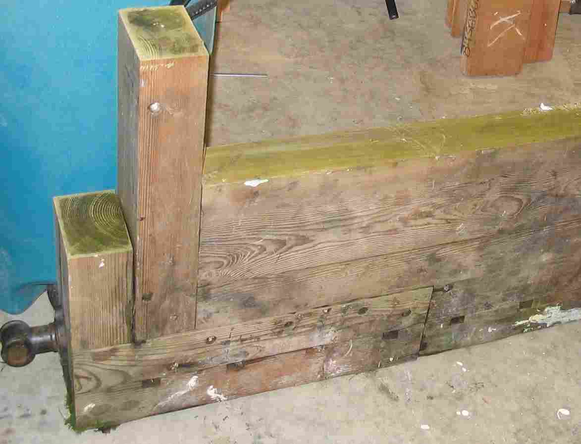

Matt Williams Marysville WA
>I picked up an old bench top with end vice attached this weekend from a lady who was going to through it away. I don't know if the bench top is any good as it has been out in the rain for some time and it seems like it is missing part of it. If it doesn't warp or twist I will probably use it as is, if not do you have a link to show how to build the vice like Frank Klausz?
Thanks.
