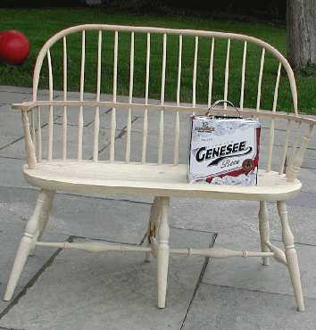

Finished Settee in the white
Greg B�tit, Vergennes, VT

Re: Finished Settee in the white
Dave Anderson Chester,NH
>Nice settee Greg, but I can't say much for your choice of brew. I went to school with Duff Whaley whose family used to own Jenny, and even they didn't drink the stuff- strictly Michelob for them.
If I'd know you were attending the settee class I would have stopped by. I only live half an hour away and get over to see Mike,Dan, etc at least every 6 weeks or so. I can't imagine what it's like to take a settee clas with 18 people, when I took mine 4 years ago there were only 16 in the class and it was really hard to move around then.
I guess my Emhoff bits and reamer will become collecotrs items now. By the way I don't use my reamer in a brace, I made a small Tee handle for it and it's much more accurate to use. That's the way Dave Sawyer teaches.
Alan Hamilton
>Greg,
Very nice work. Windsors all look so delicate to me; yours looks very elegant besides.

Congratulations and Question
Wiley Horne--Glendora CA
>Hi Greg,
That is a truly beautiful piece of furniture! I have a question: What is the finish? Is it milk paint? And does the figure of the wood show through--I can't quite tell?
Thanks in advance, Wiley

Re: Congratulations and Question
Greg Betit, Crown Point NY
>Thanks. The chair is not finished yet.
Generally hand made Windsor chairs are painted because they are made of different kinds of woods. My settee has ash spindles (we had to make them before the class, and that's what kind of log I had lying around). The Windsor Institute supplies green red oak stock to make the steam bent bow and arm rail and white pine for the seat. The arm stumps and undercarriage are hard maple. You can imagine that applying a uniform 'natural' finish on such a combination would be difficult.
I generally use milk paint, with a top coat of Danish oil or boiled linseed oil, followed by paste wax. Some guys use oil paints like Old Village, etc. One guy in the class said he used black Rustoleum on one of his!
Greg
