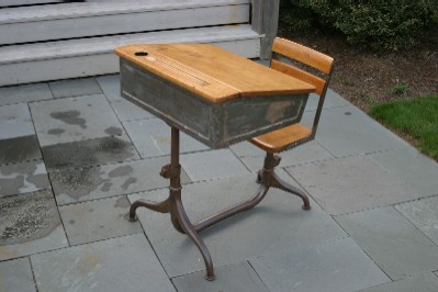

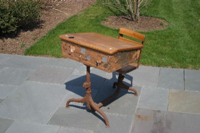

>Guilty as charged. I found a rusty old schooldesk at a yardsale. The only damage was the $5 dent it put in my wallet. The gentleman's kid's outgrew it and it spent several years out in the garage. Cleaned up real nice, but it would have taken way more time than I wanted to spend on it if I hadn't tried the wire wheel and a wire brush. Here's a before picture
Clich here for after picture
