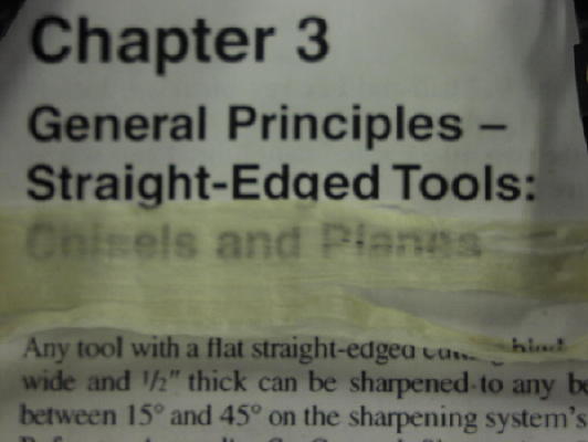

I don't have a huge sharpening test or review or anything, and I've only sharpened 5 chisels and one plane iron with the MK.II. Nonetheless, I was able to take my Veritas low-angle block plane iron (which I am ashamed to say I never even modified from the day I got it and have used it all the time for about a year) from having many edge fractures, nicks, etc. to fully honed in about 5 minutes. Woo hoo!
Here's a picture of the 0.001" (approx. using my micrometer) shaving I made from some pine I had laying on the bench using the block plane. For me, this is a God send.

>Sounds like a great aquisition! Did you get ALL the grits and spare platters? Are you using any ultra-fine-grit, third-party, sharpening film?
BTW, is that the manual for the VMkIIPSS?

And, yes, that is the manual for the MK.II PSS. The manual is great, excerpting a lot of the material from the Sharpening Bible. It has great info for machine set up and sharpening info, including info on microbevels, back bevels, various rationales for different angles for different applications, etc.
