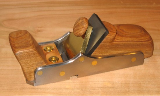

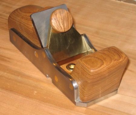

After at least hundred hours of fun labor is finally my infill plane ready. I had no patience to dovetail together the rear sole with the sides, instead I screwed and epoxied them. The front sole is adjustable and fixed with the two brass nuts. It is easy to adjust the mouth. Now it is set to 0.1 mm (approx 0.004 inch). I think it will be possible to go down to 0.05 mm if you take very shallow cuts.
The blade is 6 mm (1/4") cryo hardened A2-steel and the wood is ash.
I have tested it a couple of hours and it works fine. On difficult woods I get some tear-out but I hope to reduce that by decreacing the mouth.
Thanks,
Svante

A very nice Infill plane
Scott Burr in Ben Lomond CA
>I might add. At what angle did you bed the blade? Looks very nice, is it comfy to hold?
Re: Infill plane
Re: A very nice Infill plane
Svante Nilsson
>Thanks!
The angle is 52 degrees. The idea with an asymetrical rear handle was to get a better grip and balance. I have not worked with it long enough but it is more convenient than my Krenov-styled wooden planes.
Svante

>Looks interesting.Could we see some more pics?How about one of the sole w/adjustable mouth.
Mainely,Bob

>Hi Svante,
Very crisp and clean, as all your designs are! I have one question--what is the blade's bevel angle? The reason I ask is that you mentioned you got some tearout on difficult wood. With 52 degree bedding, you could easily go to a 35 degree bevel (or secondary bevel) and still have plenty of clearance. The steeper bevel would cut down on vibration and flexing at the tip, which could be considerable on a thick blade.
But the main thing is--this is a plane to be proud of. Thanks for sharing,
Wiley

>Nice work. Was this your first user built plane? Was this your own design? I hope to try this someday but is looks like quite a task to work with metal.
Curtis

>looks like a well done job. but why ash in a infill? shame on you (G)
something must be a bit off to get tearout. well maybe I should ask what wood your planing? I never found a tight mouth super critical on my infills. I tested a few with really tight to .007 mouths on the same nasty wood and they both worked the same.

>Hi,
The front sole has two embedded screws. The sole is not glued to the wooden front knob or the steel sides but kept in place with the two brass nuts on the knob.
To adjust the mouth I lose the nuts. Put a feeler with the desired thickness between the mouth and blade and tighten the nuts.
Regards,
Svante

>Did you send the iron out to be heat treated or buy one? Looks fantastic.

>Hi,
I bought an Uddeholm steelbar (tradename is Rigor but it is equivalent to A2). Cut and and grind it before it was sent for cryo-hardening. After hardening I have only lapped the blades. I made ten blades in various sizes.
Regards,
Svante
