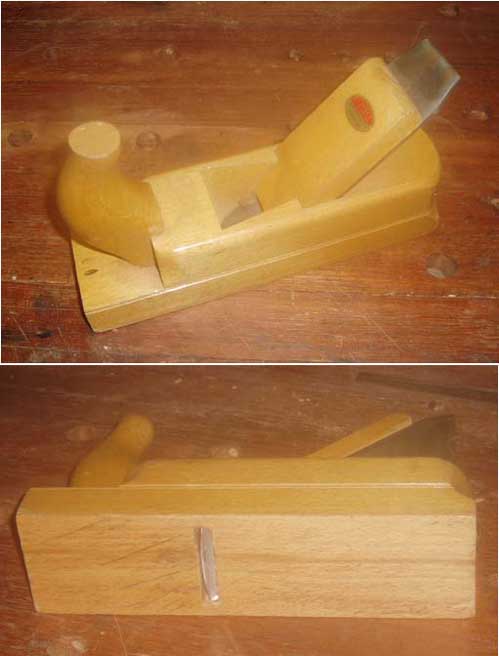

>Rob
I made a wonderful scrub plane out of an old Danish horned woodie. This had a blade that was 1 3/4" wide and 1/8" thick. The old Euro woodies are typically constructed like this. Look out for one.
The important points for consideration are:
(1) a woodie is not only lighter than an iron plane (such as a #40), but glides over timber more easily.
(2) The blade needs to be narrow, about 1 3/4" (same as #40 or a #3) is much better than a wide(r) blade, which requires more effort to push.
(3) The thicker the blade the better. The thinner standard Stanley blades (like your #5) will flex under the load.
While you can radius the blade freehand, I made up a jig to do so on my high-speed grinder. Just a piece of timber the same size as the blade, one end radiused as you require. Screw this to the blade, extend as far as necessary for the desired bevel angle, and then use the curve as a template against the grinder's rest to steady and shape the curve.
On my blade I aimed for a 3" radius, which was approximately 1/8" (from memory) down at each corner.
I hope this helps (and my descriptions make sense)

>Either make your own, Steve Knight style, or buy the ECE.

>I just got done doing the very same thing, and picked up a #40 for rough flattening. It worked well enough, but I found myself wanting a little more room between the handle and the back end of the blade. I couldn't get the handle quite tight enough, either - if I was going to do it again with a metal plane, I'd go for the 40-1/2. The added weight is minimal when you consider how hard you're pushing to cut through the wood. A lot of guys go for the horned plane (seems to be the top choice), and of course Steve Knight has a very good rep.
I thoroughly enjoyed flattening my bench top, and it was fun to cover the floor around it with shavings - It's one of the few times I've worked up a sweat in my basement shop. It was also easier than I suspected. I got it close with the scrub, finished flattening with a #7 or #8, and touched up with a smoother. If you haven't glued up your top yet, make sure you orient the grain so it runs in one direction as much as possible, and use the scrub on the diagonal, alternating direction to help keep it flat. Also, mark the final thickness around the top with pencil, so you can see when you're getting close.
