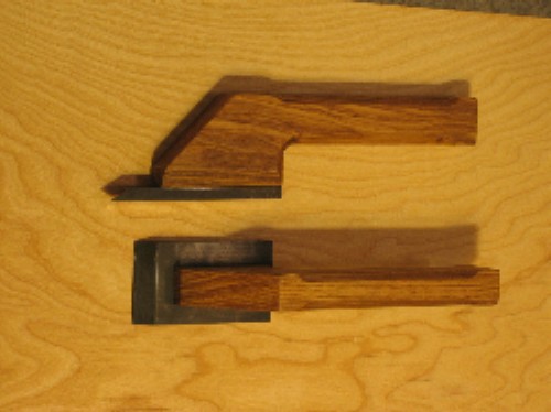

Svante Nilsson
>Hi,
Made two chisel planes. The blade is A2 steel. Before hardening I drilled two holes to fasten it to the handle. Wood is Ash.
Thanks,
Svante

>you could also see them as another way to get a cranked-neck chisel at more affordable prices than US$45-60.
Re: Chisel Planes
Re: Very clever
>Exactly what I was thinking. These would be easily built and easily customizable crank back firmer chisels. OTOH, they don't really work the same way as a chisel plane, because they have 0� relief angle. This allows them to easily remove high spots, but they're not optimum for taking down an already flat surface right up into a corner.

>No, for that you need a Stanley No. 75.
Joking, joking...
