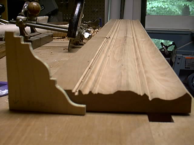

>I am making a cornice moulding for a repro secretary desk (cherry). Here is the first rough moulding (two required-one for the front and one to cut up for the sides). I am using a Stanley #45 with 1/8" plow to cut starter grooves, a #93 to square them up, and an H&R set for curves. Just start at the top and work your way to the bottom.

>Jim,
That's great work! I thought you might have used your 46 on it though!
One quick question: How do you hold mouldings while you plane them. Wide strips seem easy but simple/narrow profiles seem like they would be hard wih a plane that requires a fence to register them.
BTW, you'll have to post pics of the finished project now!
Brad
Re: Weekend moulding project
Tie me down mate
jim_reed@marietta
>Good question. I clamp the board between two bench dogs. That is why I needed to make two pieces--the total length exceeded the length of the bench. So clamp it down, and use the sides of the board for references and fences. After I cut the front profile, I cut off the waste width and planed the edge and back.

Chris Knight
>Moldings can be held by nailing a couple of boards together to create a sort of long shooting board, then putting a nail in one end of the lower board, close to the step created by the upper board against which you lay your molding.The nail acts as a planing stop.
