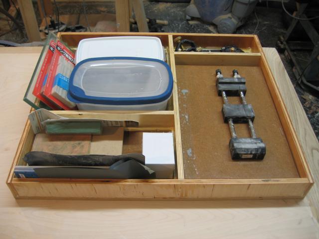

I finished my sharpening tray... something I decided to build to hold my stones, jigs, etc...
MDF+ scraps of plywood glued with gorilla glue and caulked around the seams...and finished with 4 coats of some extra Poly I had.
It worked pretty well last night when I sharpened 3 blades.
I was also pretty happy with the edges I got..
One thing though... I use 220 W/D paper on float glass to flatten the stones. It takes a while to flatten the 1000 ... None of the other grits take long at all.
I also have gotten faster... I averaged about 13-15 mins a blade... However, the backs had been mostly flattened during prior sharpening sessions, so I did not have to do much on them. I decided to redo the backs on these blades just to insure a good starting point using water stones.
It seemed to work pretty well. I planed some poplar and was able to pass D. Charlesworth's "newsprint" test which involves placing a shaving over some text and being able to read it easily.

Christopher Fitch @ Memphis
>heh...
I realized very quickly that pulling my stones out of a cardboard box and having to lay down a plastic bag for the water was not only a pain in the neck but would discourage me from keeping my blades sharp(er).
So I scribbled a drawing down on a piece of paper, did some rough layout with my equipment and figured out a workable size. Then it was just a matter of finding the scrap, cutting it down, and gluing/nailing it up.
The longest parts were waiting for the glue and caulk to dry along with the poly.
One thing... you want your platform that your stones sit on to be high...
It's hard to tell from the picture but the stone holder on the bottom right sits on two pieces of MDF which puts the holder higher than the rest of the tray. It's high enough to allow for easy access but low enough to catch water..
One thing that works well is that I can move around the tray real easy so I can use different parts of the stone without having to move the holder.
>Yeah, I thought the same thing about the time. So I made that... It's nice to be able to pull stuff out and get to work with little effort.

Don Thompson - South of Miami
>Are you not worried about water messing up the MDF on the bottom?
(I have to make something similar for my wife, and I have been contemplating what to do with the bottom and the joints)
>Could you be more specific? Are you referring to the MDF base or the sides?
The bottom is made from one piece of MDF while the sides are 2" strips of plywood glued with gorilla glue and nailed to reinforce areas. After I finished building it, I used silicone caulk along all the joints along the MDF base.
After that dried, I applied four thick coats of polyurethane along the bottom and sides and top edges.
Once that was done, I even put some paste wax over in the holder area for even more protection.
The water beads up and floats on the top of the MDF in the holder section.
I soak up any remaing water with an old rag or paper towel.
