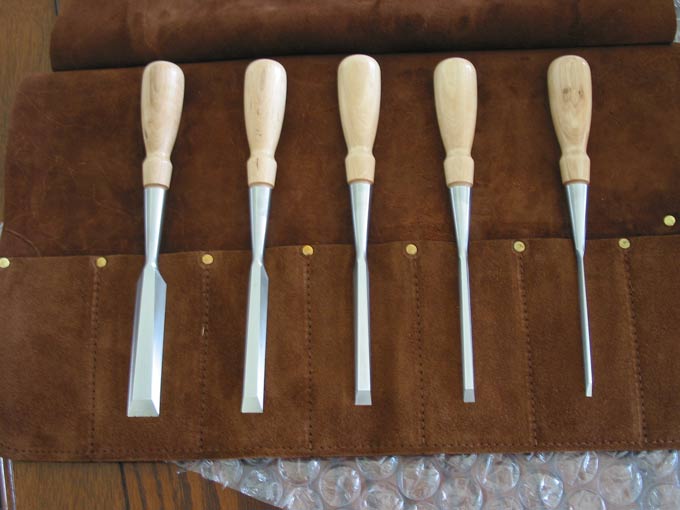

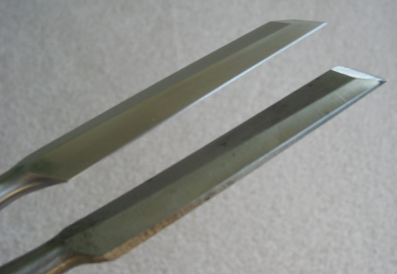

Todd Stock
>In the recent discussion on LN chisels, several folks mentioned that they could see nothing in the design or execution to merit the $50-a-pop price.
Although I had seen prototypes prior to receiving my set (with an insert claiming that it was one of the first 100 production sets, no less), I was reluctant to join the discussion without tool in hand to compare to my late '70s Double Cherries and my 750s.
The shot attached is of the 3/4" size LN and 750, and shows the one feature that justified (in my mind) the investment - very sharp, very thin, perfectly milled edges.
Compared to the 750, the LN's milling is almost delicate. When compared to my Sorby long bladed patternmakers chisels, the edges of the LNs are milled to be just a bit thinner, and taper toward the socket of the chisels, instead of towards the tip. There is no rounding of the edges, most likely because the LNs are machined to final dimensions and left unbuffed. This feature alone is worth a few hours of my time spent resquaring these edges on buffed tools.

Todd Stock
>LN says they are A-2 steel, and that the blades are RC 60-61. From the initial prep (flatten back, grind, hone), I'd say they are harder than the Double Cherries and much harder than the 750s, which says that LN probably is about right.
While I was prepping the LNs, I rehabbed an older 750 and did weekly touchup on a steel cap Stanley carpenters chisel I keep in my bags; I could really feel the difference in hardness - the LNs almost sang on the paper, while the 750 was duller feeling; the soft Stanley were 'dead.'
I'll write up a usage test when I can spend some time chopping out dovetails in some of my 'devil wood' stack - till then, here's what I see:
- All machining/grinding appears to be to around 600 grit, with no evidence of rounded over edges or buffing.
- Sides are square and tapered to around a 1/16" - nice for cleaning out dovetails without reaching for the skew. These edges are narrower than those on my super flexible patternmaker's chisels, and about three or four times narrower than either the DCs or the 750s I've owned. If you have had a chisel that tends to tear out at the corners, it's likely because of rounded over arrises between back and sides - not the case here.
- Unlike the 750 and my DCs, the sides and all bevel work are finished as well as the primary surfaces.
- Unlike the 750s, the LN chisels are scaled in thickness - the 1/8" is lightly built - about half the thickness of a Stanley, while the 3/4" is actually a bit beefier than the prototype.
- I like traditional methods, and I prefer English Engineering System units for woodworking. The LNs are literally a few thou narrower than the nominal EES dimension, which is just right.
- Fist impressions are that LN got the balance about right for a bench chisel that would be used for both paring and chopping.
